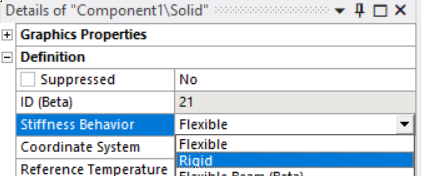

I want to model the wheel and the bogie as a rigid body, in which I have as given the mass of the wheel, the mass and the inertia of pitch motion of the bogie. How can I do it in Ansys Workbench ?

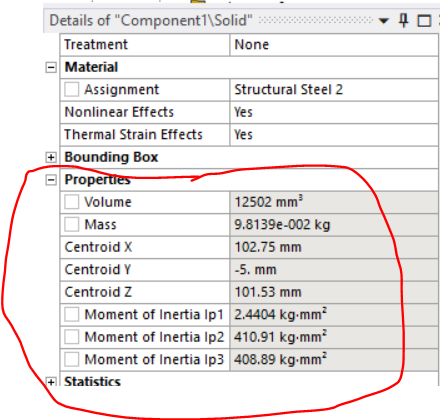

SubscriberThanks for your response, yes I know to define rigid body, but how I have to define the mass for the wheel and the the mass and the inertia of pitch motion of the bogie in Ansys Workbench. Thank you so much

SubscriberYes, how to modify it ? should I calculate the volume and then the density to put it in the material property

The volume is determined by Mechanical based on your geometry. You can modify the density in Engineering Data.
