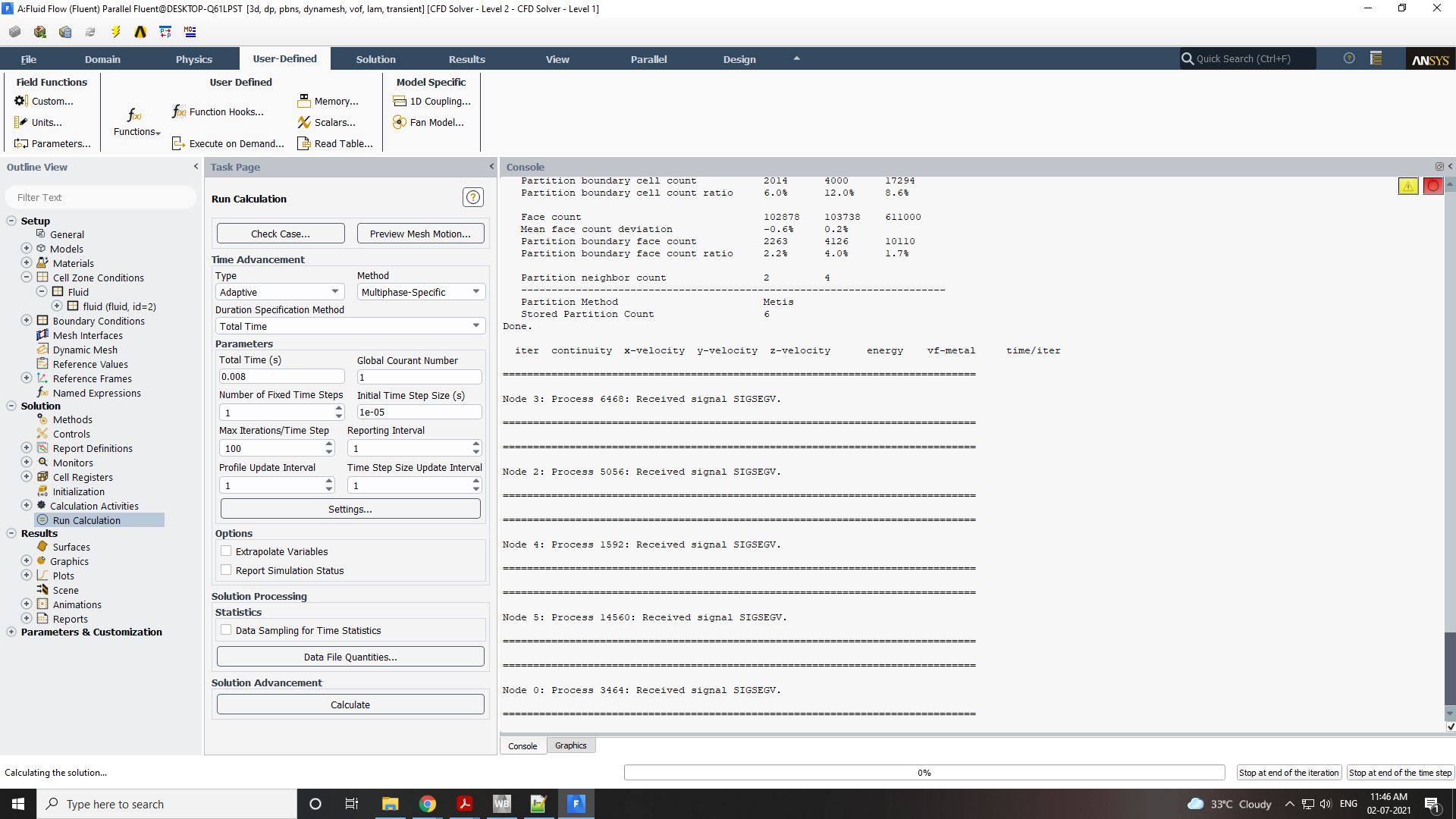

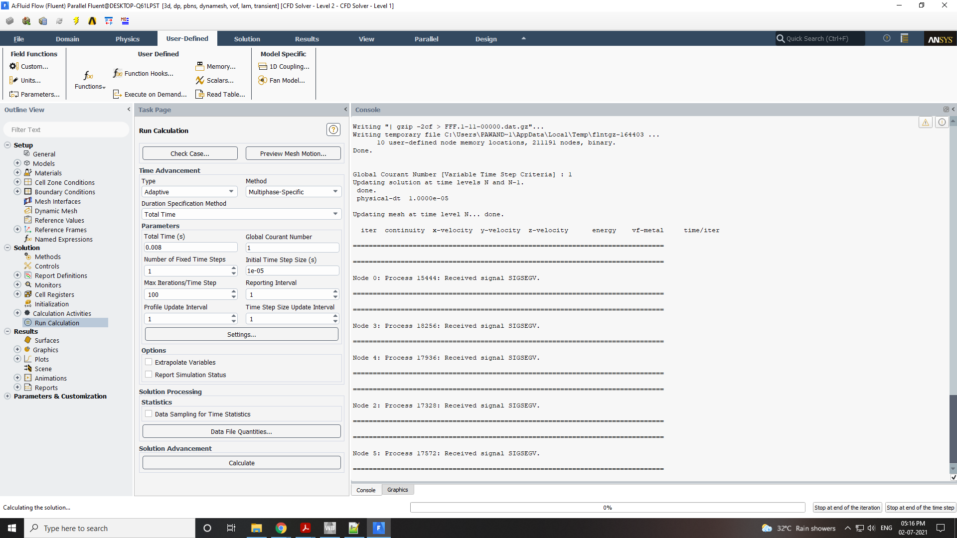

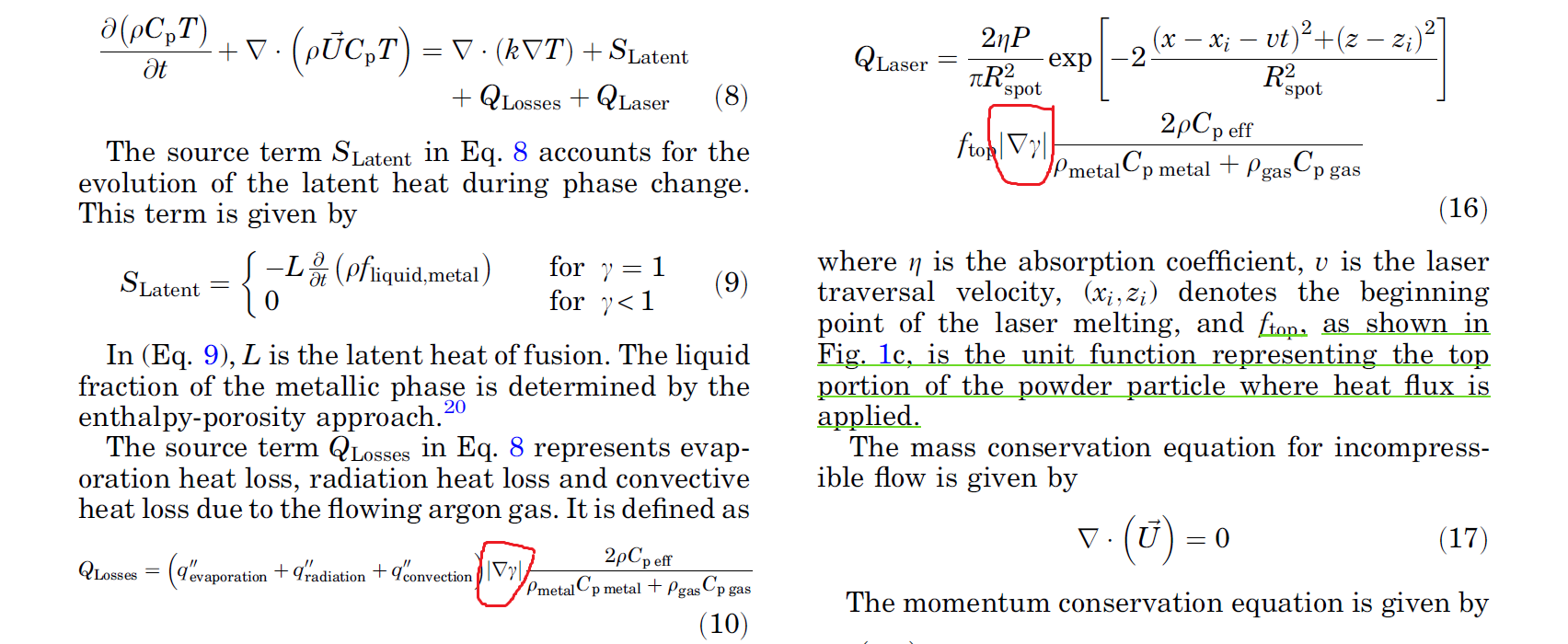

      Sorry to disturb you all again. It's just that I am very new to UDF and running out of time due the loss caused due to the pandemic. My work is modeling SLM and I am trying to start with melting of a solid block with inert gas above the substrate. I have attached my model and UDF. I have written the UDF by taking help from this forum and other sources.
      I am trying to add this magnitude of gradient of volume fraction in the energy equation as shown. The UDF compiles without any error and initializes also without any error. When I run the simulation, Fluent crashes with the errors shown in the image below. I have attached my UDF also. I would be really grateful if someone could help me with this. I am new to UDFs and perhaps have made a mistake in writing it.

      Have you switched on enough UDM in the solver? It's not automatic.
    • Dubey92
      Yes Sir, I have allocated 10 UDMs in the solver(I think more than required). The code shows no error on compiling and initialization. When I run using calculate in "Run Calculation", FLUENT writes somethings and then crashes with the error.
      This is the error and then FLUENT window closes automatically. Can you suggest something? Is my code to store the VOF gradient right? The initialization code is working fine.
      Do NOT post questions in multiple threads. If you do have separate questions keep them that way and don't mix and match.
