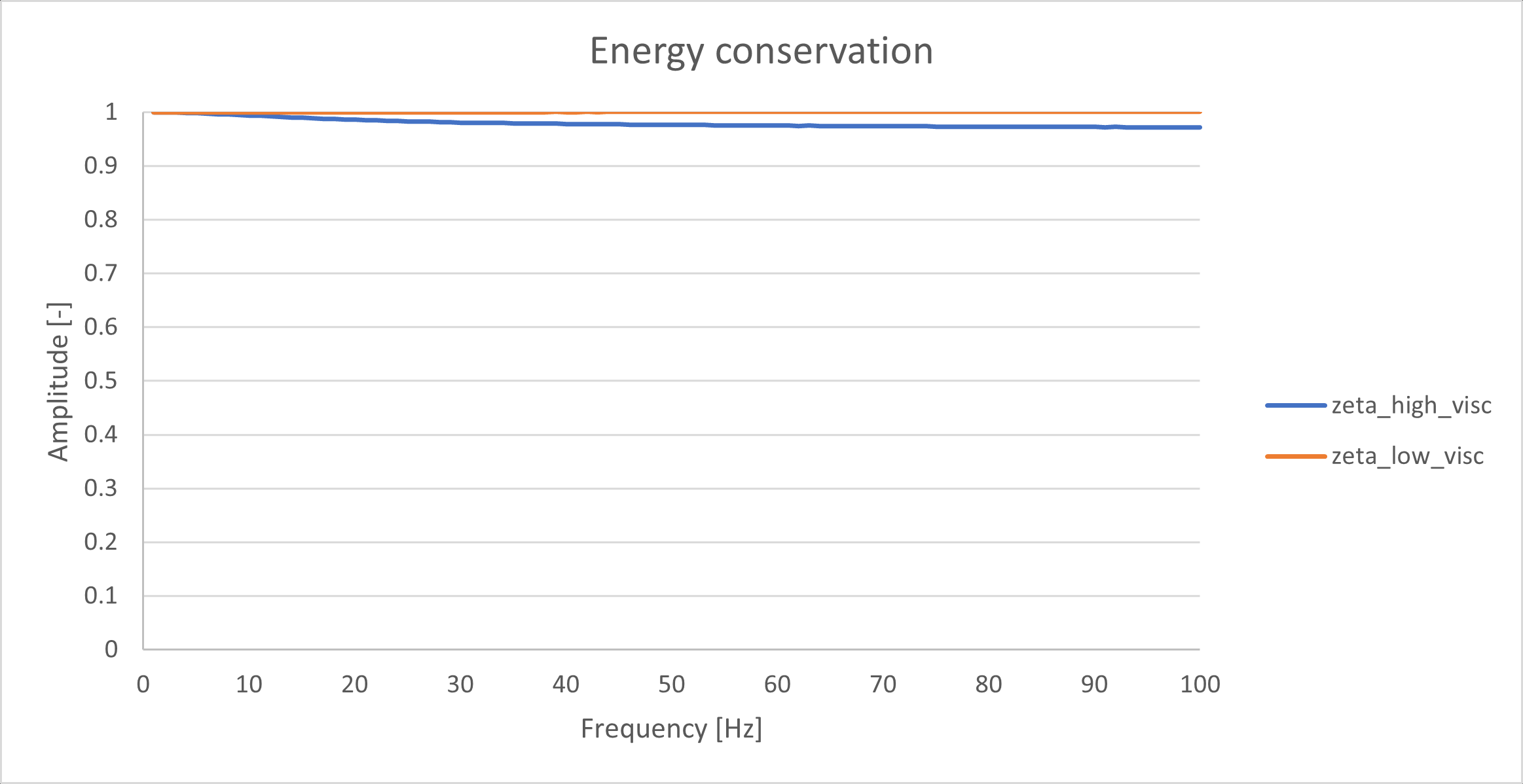

      I would like to take damping into account at my current simulations of acoustic transmission. I spoke to someone who mentioned that damping would be described and calculated within the solver if my geometry has a material assigned with a defined viscosity. Doing so I do not recognize any damping at all looking at the energy conservation, even at excitations with very high amplitudes.

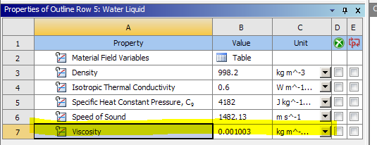

      check the ds.dat for MP commands, check that there is an MP command that is specifying VISC, or BVIS, for your fluid material

      So as we said including viscosity should provide attenuation - we do not have an example, but I made a benchmark for 1D duct acoustic wave propagation in castor oil, which gives the correct values for transient acoustics, but we use the same matrices for harmonic so it should be the same there (and we have tried that also and it is working ok). So it should all work well when using MP and VISC so the dynamic viscosity in engineering data in workbench as shown below.

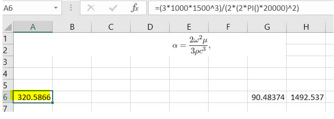

      So looking at castor oil like properties (where the attenuation relation can be described by the Stoke relation), and a 2 cycle pulse excitation of 20 000 Hz, then using the Stoke relation for an attenuation (alpha) of 1 [m-1] assumed here, we should have a dynamic viscosity of 321 at this centre frequency (see below).
      The pressure over 0.1 of a meter is for 100 Pa excitation then: 100 Pa/(exp(0.1)) ~ 90 Pa at a distance of 0.1 m from the end of the duct (excitation side). That is what we get also more or less (shown below), so it captures the attenuation fairly well.

      I was able to notice damping by increasing the viscosity of my material (just to make sure it is portrayed). Now I know that my calculations always included damping within the fluid but it was not really noticeable because the coefficient alpha was really low.
