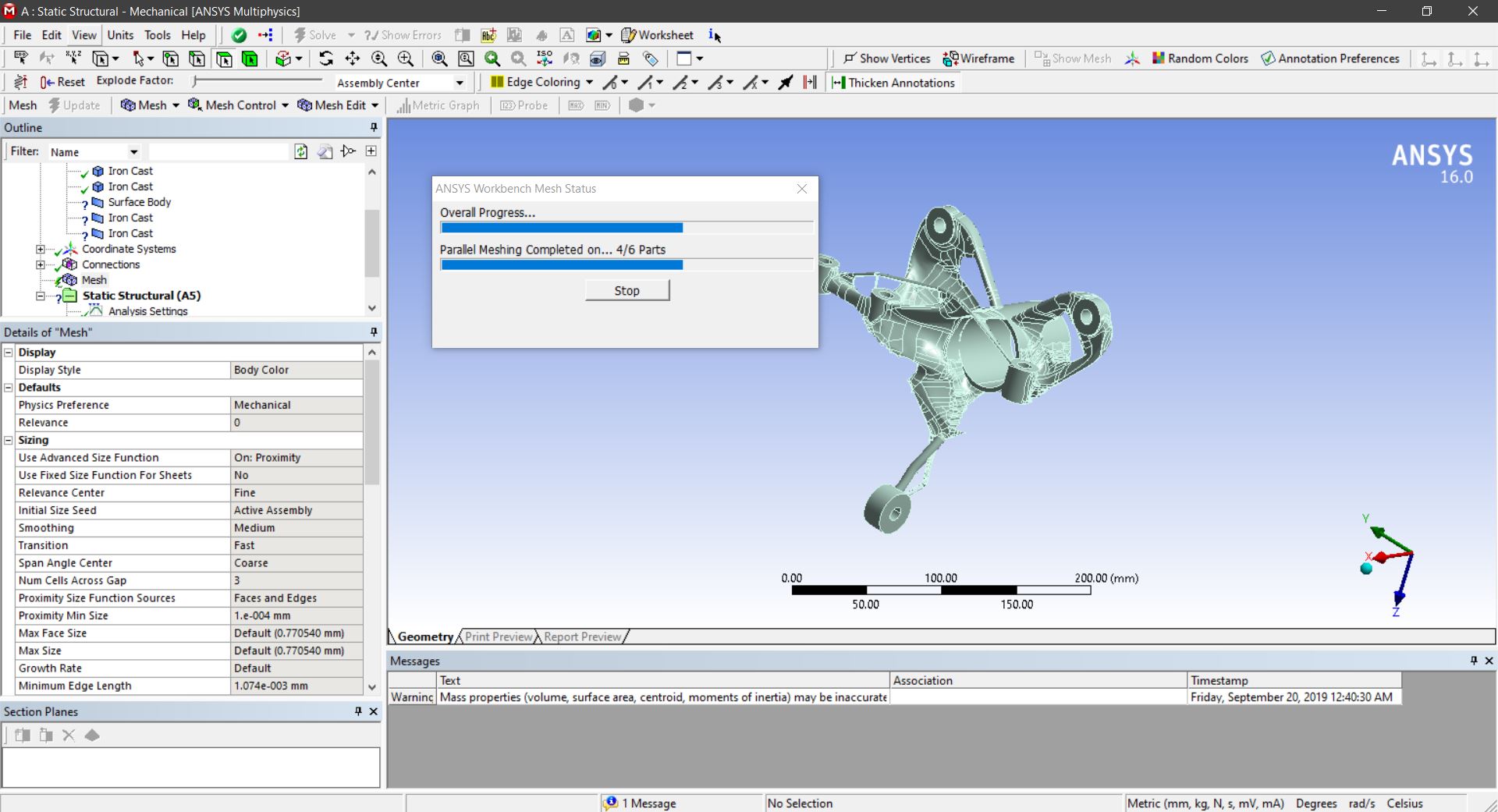

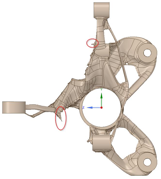

      I am studying on static structral analysis on this file which is ? shared it below. But  ? have some problems when ? am meshing it. There are a lot of faces and they are really complex. This is a generative designed model. ? know that there is some problem with model but ? am trying to keep going to analysis. do you think is it possible ? if it is possible what can ? do for that ?

      This is an interesting example of Topology Optimization. Also, in the latest version of Topology Optimization, there are settings for minimum sections which would avoid sections that are too small to be practical.
      I see some geometry cleanup has been done. There are tools in SpaceClaim for doing that.

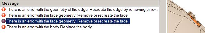

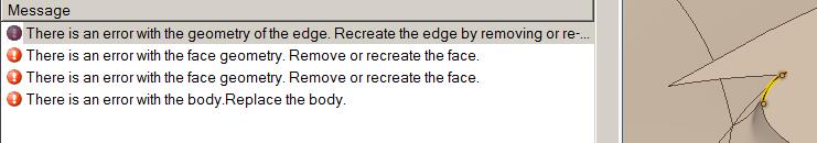

      If you do a Geometry Check when you bring this geometry into SpaceClaim there are four errors. You have to fix geometry errors before you mesh.
