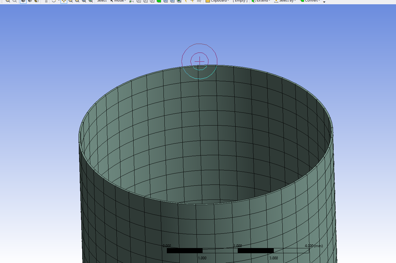

SubscriberI would like to mesh the pictured surface so there are at least 10 elements in the radial direction. Imposing a sweep method only increases the number of division in the axial direciton.

Forum ModeratorCheck the minimum cell size that's set. Also check you don't have a contact region set between the two annular faces: the gap is narrow compared to the domain size so the automatic tools may have messed up.

Forum ModeratorWhat is the minimum size, and what is the thickness of the annular volume?
