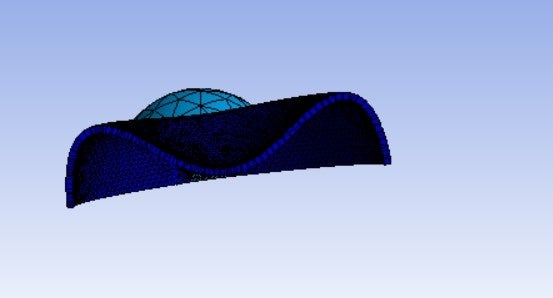

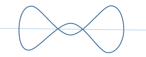

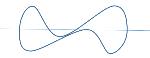

SubscribernHi, Thank you for the help. I'm thinking to go with the first suggestion adding the frictional contact with a center plane. I'm struggling with how to go about doing this, would you be able to guide me more on this?nThank you again for the help!n -
April 17, 2021 at 1:29 pm
peteroznewman
SubscribernWhat version of ANSYS are you using? Newer versions allow you to make simple geometry in Mechanical. In older versions, open the Geometry editor and make a surface much larger than the size over which the cell might stretch. Bring that surface into Mechanical. Set the behavior of the surface to Rigid. Select an Edge and use Remote Displacement to hold the surface fixed. Insert a Frictionless Contact between the surface and the inner face of the cell.n -

SubscribernI'm using the 2020 version of Ansys, will apply this to my model now. Will the material of the surface have an impact on the results? nReally appreciate the help!n -

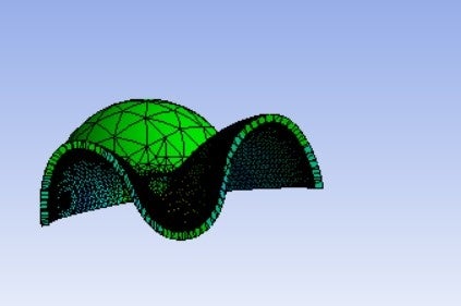

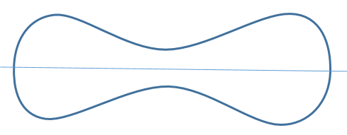

April 19, 2021 at 3:21 pm
Wazawaki
SubscribernThe model now stops when the two halves meet! Would you know how to measure the axial and transverse diameters after deformation?nThank you!n -
April 19, 2021 at 8:13 pm
peteroznewman
SubscribernI assume the model plane of symmetry is at the XZ plane, so that the center plane has a coordinate of Y=0. I assume all the nodes are on the positive side of the Y axis.nPlot the Y Deformation. You can export that as a CSV file with the coordinates of the nodes.nNow you will have a file with five columns as shown belownID, X, Y, Z, YdeformnMake a new column TransverseDiameter = 2*(Y-Ydeform)nn -

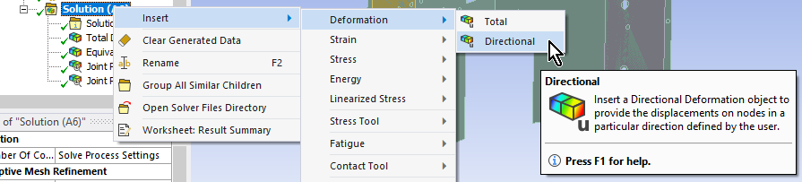

SubscribernThank you for all the help! One last question, how do I go about plotting the Y deformation? Have been struggling to figure it out.nn -
