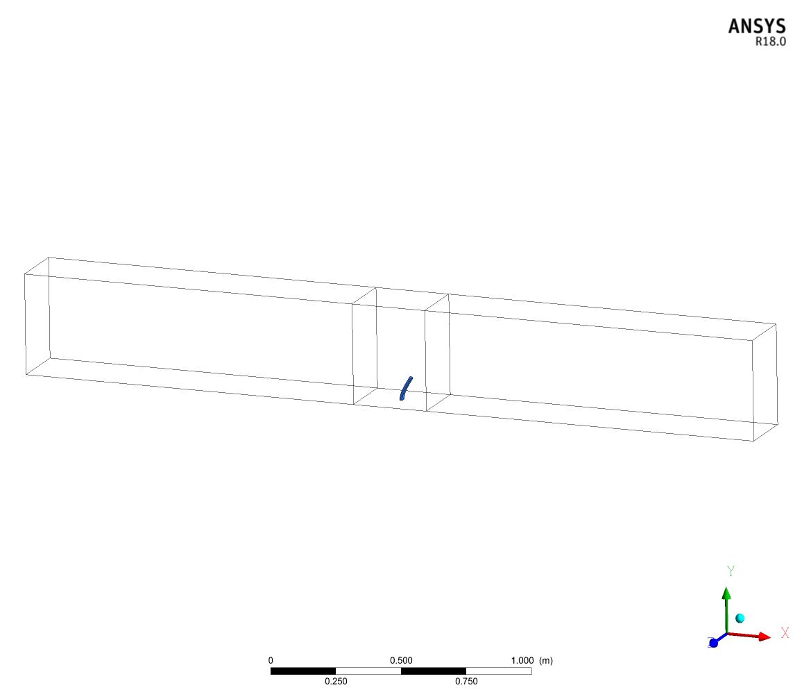

      My question is how to measure the length of a reticulation region behind a bluff body in 3D.
      I am attaching my domain, and I need to calculate the re circulation length behind the bended structure indicated by blue color in the image.

      I have calculated the x-distance by considering the change in the direction of velocity vectors (neg to positive ) behind the flap at different locations.
      Does it give a correct estimate of the re circulation region?

      I am using the velocity vector direction. In my case because of low Reynolds number I don not have a prominent separation bubble but a certain position behind the flap the change in vector direction from neg to positive can be observed.
