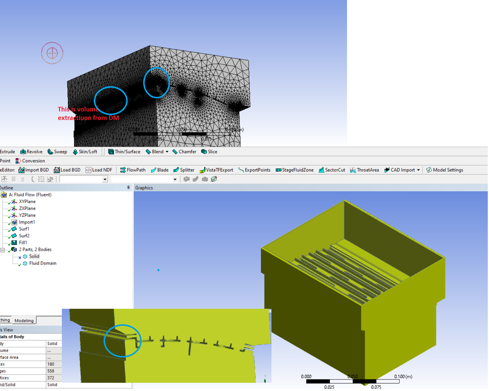

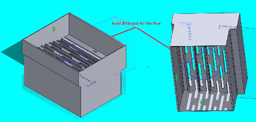

Forum ModeratorYou can pick the faces and give them a label (Named Selection). You'll need to do that with all of the walls you want to have a unique label. More critically, where does the fluid get in and out?
March 15, 2022 at 2:37 pmhamiddehkordi
SubscriberHey Rob
thanks for the reply, input is from top and output from bottom
is it only for unique lable or later in settings I can add wall boundary easily?
please look at the left side of green photo (inside the blue circle) should I select all the surfaces is going inside?
I want to select the middle web area as porous zone but since from left and right it is connect to walls I do not know how to separate them
March 15, 2022 at 3:15 pmRob
Forum ModeratorIf you want a porous zone it's a cell zone (volume) condition, and you won't need the grate. You may find it easier to pick the main walls, and then hide those faces: then box-select the grate.
March 15, 2022 at 3:37 pmhamiddehkordi
SubscriberThanks but I do not still know how i should treat the end connections of the grater and the walls, they are connected through grater
March 15, 2022 at 4:29 pmRob
Forum ModeratorYou need to decide which bit is porous media and which bit is solid. That comes down to what you're wanting to learn.
March 16, 2022 at 11:45 amhamiddehkordi
SubscriberThanks Rob, I will see, I might come back to you for some other tips.
