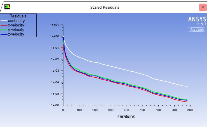

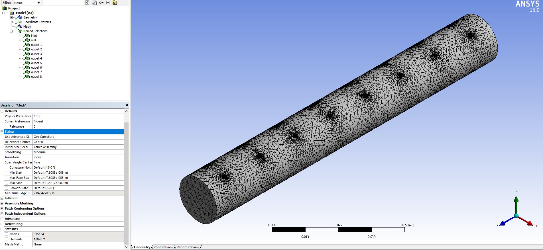

SubscriberHello my name is Valdi and I'm trying to simulate the flow maldistribution in micro-channel heat exchanger. My consideration in this simulation is only the velocity of the fluid which are using water at 10c with 999.7 kg/m3 of density and 0.0013053 Ns/m2 of viscosity. The inlet velocity of the water is 1 m/s.

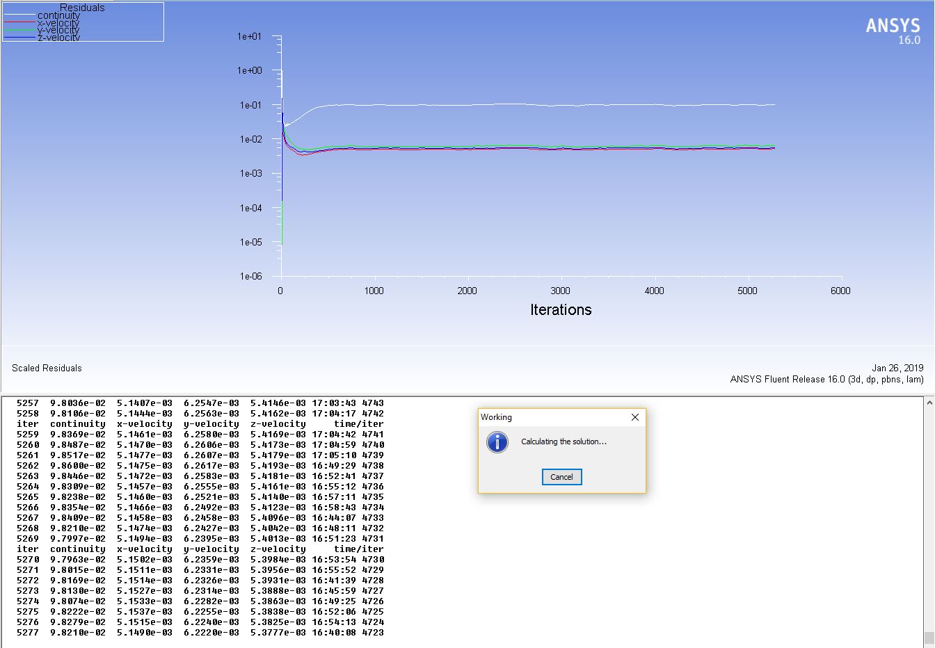

The problem found is the solution is not converge due to the graph of continuity that static on around 10e-2 as shown in the figure below.Â

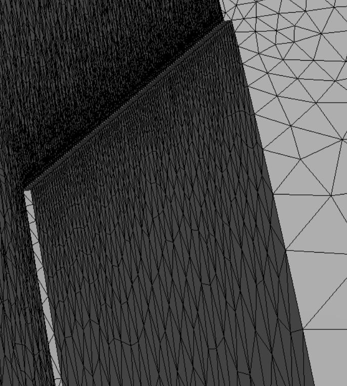

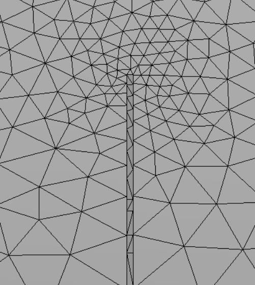

Below is my mesh.

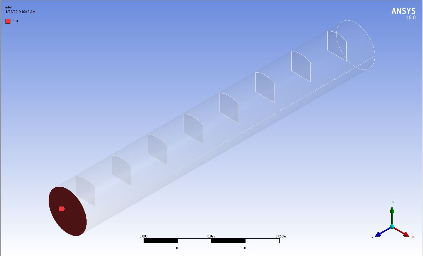

Below is my inlet port.

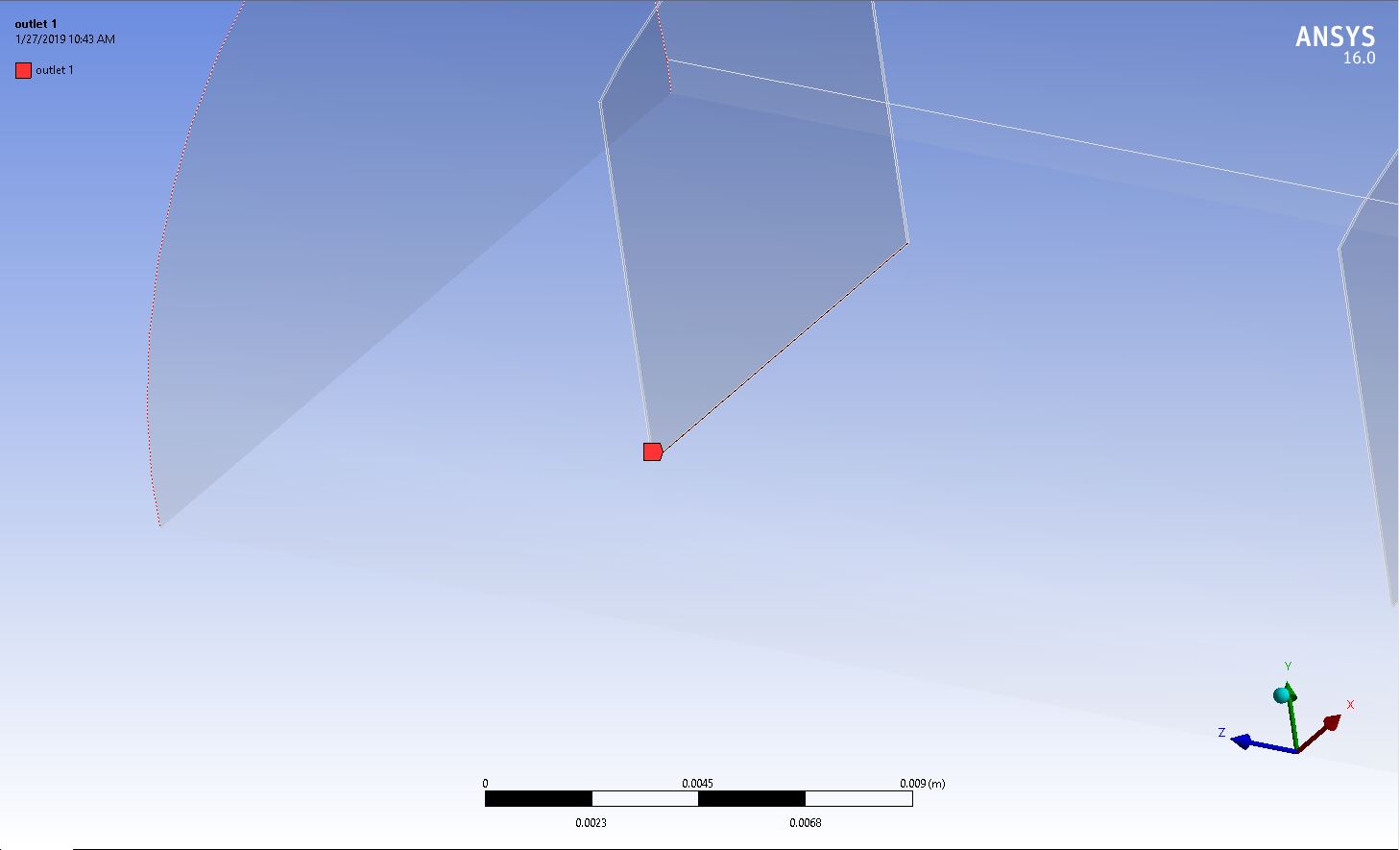

Below is my outlet though all the 8 ports.

peteroznewman
SubscriberHello Valdi,
If you Clear Generated Data on the Mesh, then the archive will be small enough to attach to a post.
The mesh has 1.7 million cells which is larger than the 512,000 cells allowed on the Student license that I tried to open it with.
If you cut the geometry in half and use symmetry, you can reduce the compute time and allow it to be opened with a Student license.
The question I have for the CFD experts on this site is whether a single cell across the width of the outlet slits is sufficient to converge the model. I'm going to guess that putting more elements across the slit width would help the model to converge.
Regards, Peter
January 28, 2019 at 3:53 am
peteroznewman
Your inlet velocity is 1 m/s on an area of 314 mm^2Â and outlet area is 4 mm^2
That means the water must have an average outlet velocity of 78.5 m/s!
That sounds absurd to me, especially when you have Laminar equations selected.
I changed the inlet velocity from 1 m/s to 0.01 m/s and the model is converging just fine.
Regards, Peter

January 28, 2019 at 1:38 pm
peteroznewman
In the experimental research, what inlet pressure is required to push water in at 1 m/s that has to exit at an average velocity of 78 m/s? Are you sure the inlet velocity isn't 1 mm/s?
I can't send you the converged model with the inlet velocity set to 0.01 m/s because the file size is too large to attach, but it didn't take long to compute.

January 28, 2019 at 5:28 pm
Rob
Forum ModeratorYou'll need a lot more than one cell on the outlet and if the speeds you mention are correct you'll also need to refine the mesh around the baffles/outlets to capture flow separation and recirculation zones. Flow separation may also occur in the outlet channels which could mean you see a higher velocity as not all of the surface is used.Â
Combine the mesh and flow speed and convergence is going to be difficult: you may also find it's not much better with a finer mesh as you'll be picking up the time dependent nature of the flow so may even need the transient solver.Â
Peter - you're doing fine with CFD keep going!Â
