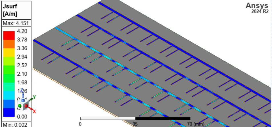

      I would like to make a 2D contour plot in the Fields Report section. I am able to plot the fields in the HFSS 3D modeler window, as shown below, but I can't figure out how to export this onto a plot. The reason I would like to do this is to ultimately export the fields data as a csv file.

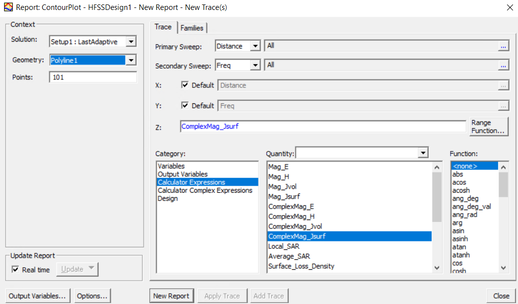

      I have tried making a 2D contour plot by going to Results --> Fields Report --> 2D Contour, but the issue is, it only allows me to input polylines as the geometry rather than some surface I have defined. Any help for creating a 2D contour plot is very much appreciated.
