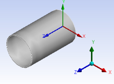

      Hello,nI don't think I have a problem with the orientation of the axis system. You can see this on my screenshot.nn
    • Sean Harvey
      Hello, if you insert a results under solution of coordinate system, element triad, you will get a plot. Notice how my element triads are aligned with global, and not cylindrical coordinate system. So, you will want to be sure this is correct to get proper thermal and structural behavior. This assumed solid mesh which appears is your case. For shell mesh, the z will be normal, but still the x and y may not align as you wish.nHow to fix this? Right click on geometry then pick element orientation. There you can can use the defined by to use a coordinate system or surface and edge guide.nPlease try and see if that helps. Thank younSean

      Hi,nOkay, thank you for all these explanations!nAlso, I would like to know if is this the right orientation of the coordinate system. Because my structure is a pipe that will be made by the filament winding process and the orientation of the fibers will be at 90? to the cylinder. nI'm wondering if my coordinate system should be aligned with the global system as shown in the picture above because the limits of stresses given in the Engineering Data will depend on the direction of our coordinate system, this is the most important I think to get the good results.nn
    • Sean Harvey
      Hello!nAh good question. Sorry for confusion. I realize now that if you are using ACP, then in that tool you will be setting the fiber orientation. So once the layup comes from ACP to mechanical, the fiber/matrix orientation will be set (provided it is properly defined in ACP) The coordinate system of the element would be if you were not using ACP. Does that help clarify.nnThanksnSeann
