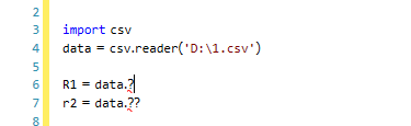

SubscriberI have a script within Spaceclaim that develops a unidirectional composite matrix with fibers. I also have an external MATLAB function that randomly generates origin locations for the fibers and I'm wondering if there is way to take these points from MATLAB (or a txt file) and have them inputted into the python script within SpaceClaim to update fiber positions on my geometry. Any ways of interfacing spaceclaim scripts with programs outside of ANSYS would be of interest to me.

June 4, 2021 at 12:14 amprheintz
SubscriberAniket
Your suggestions pointed me in the right direction. I actually discovered the code to directly read a CSV file with (x,y,z) coordinates into spaceclaim via the scripting tool.

July 27, 2023 at 11:06 pmFranc Shaw
SubscriberHi Pierce,
Could you please proivde a example code to read csv variable value into SpaceCalim by using csvReader?
