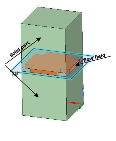

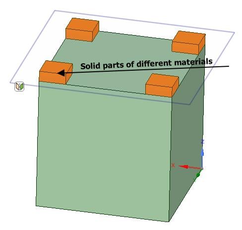

      I made some shape changes
      I will get an error when I perform the coupling operation.
      “System coupling run completed with errors.  Fluid Flow (Fluent) (Solution 3) reported: Fluent encountered fatal error after sync point Solve: received a fatal signal (Segmentation fault). Please do not save the project if you would like to recover to the last saved state.”
      I think it should be a problem with moving grid settings.

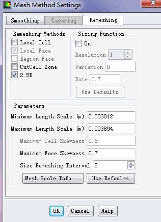

      I am not familiar with moving meshes, so I mimicked the online example to set the dynamic mesh parameters.
      Dynamic mesh parameters are as follows
      My confusion is as follows

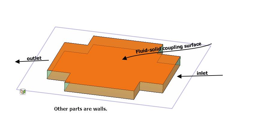

      1. Is the dynamic mesh setting for the fluid-solid coupling surface reasonable?

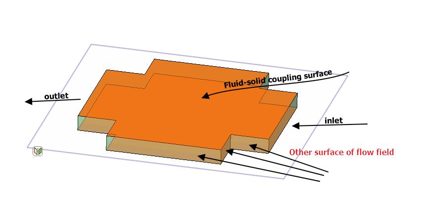

      2. Among them, I only set the lf-dc surface of the flow field and the solid contact part as the fluid-solid coupling surface. Does the other surface of the flow field need to be set as a dynamic mesh? These faces are not in contact with the solid part
    • Keyur Kanade
      as you have hex mesh, you may need to use layering.
      https://www.youtube.com/watch?v=TFNXzGZuz9Y
