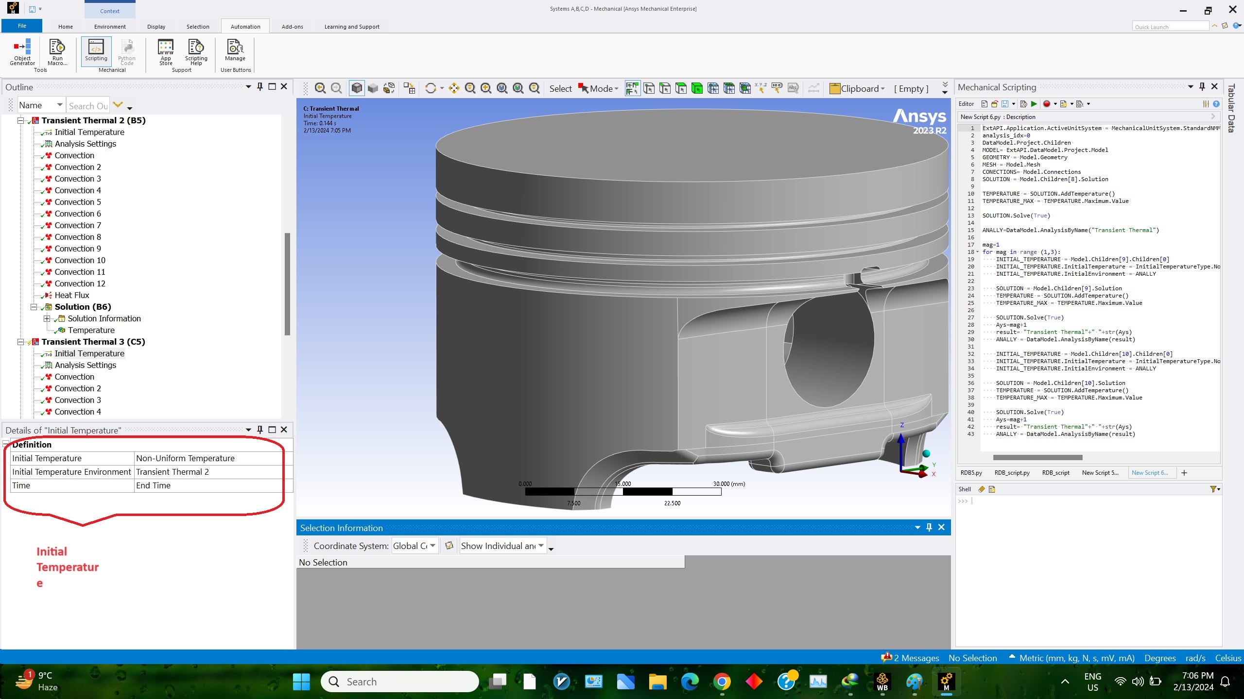

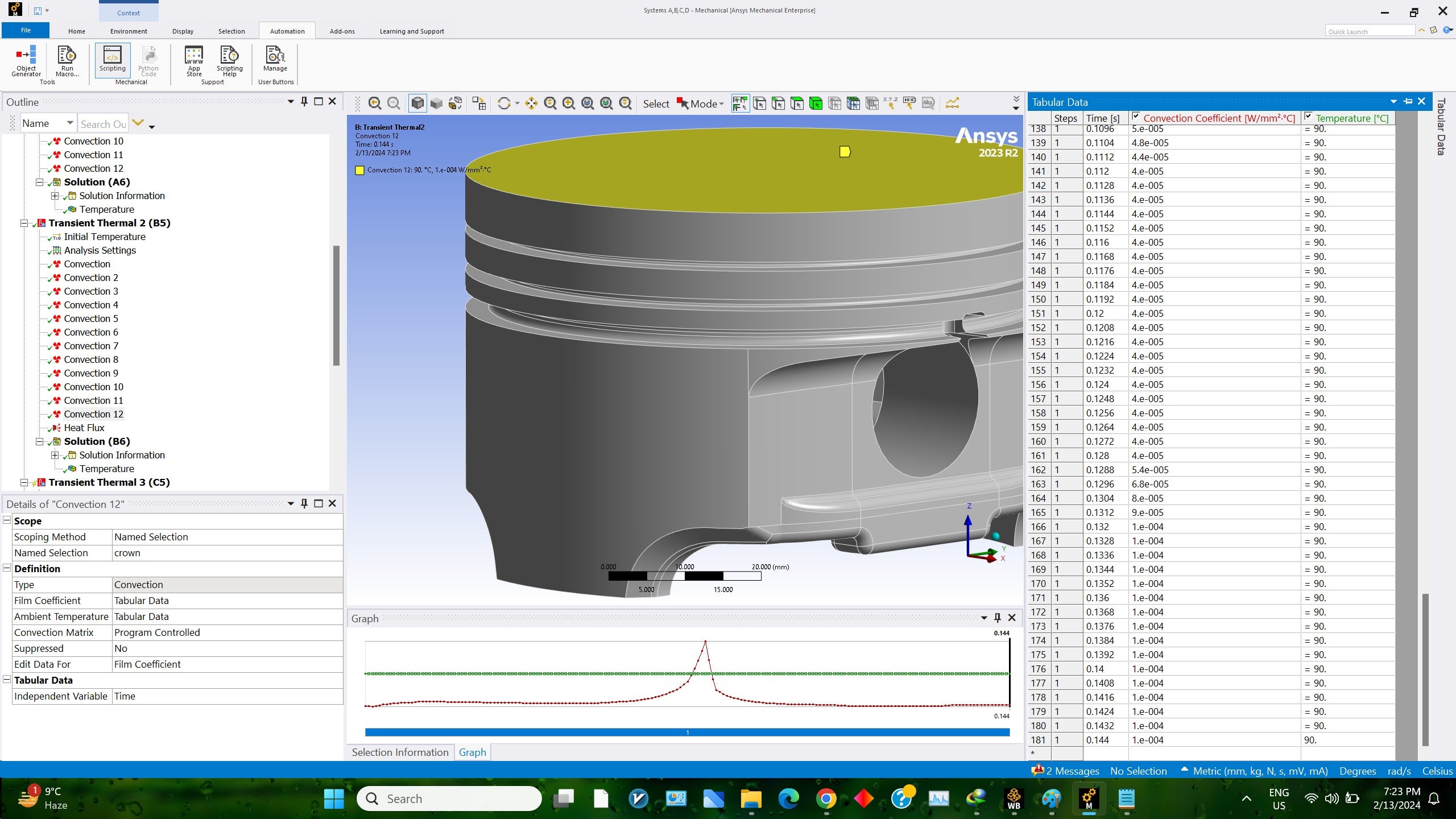

      I try to transient thermal analysis in Piston which it has cyclic BCs. apply in 0.144 sec (in 180 step). I need to find after 3500 cycle (about 504 sec) what is final temperature in Piston.

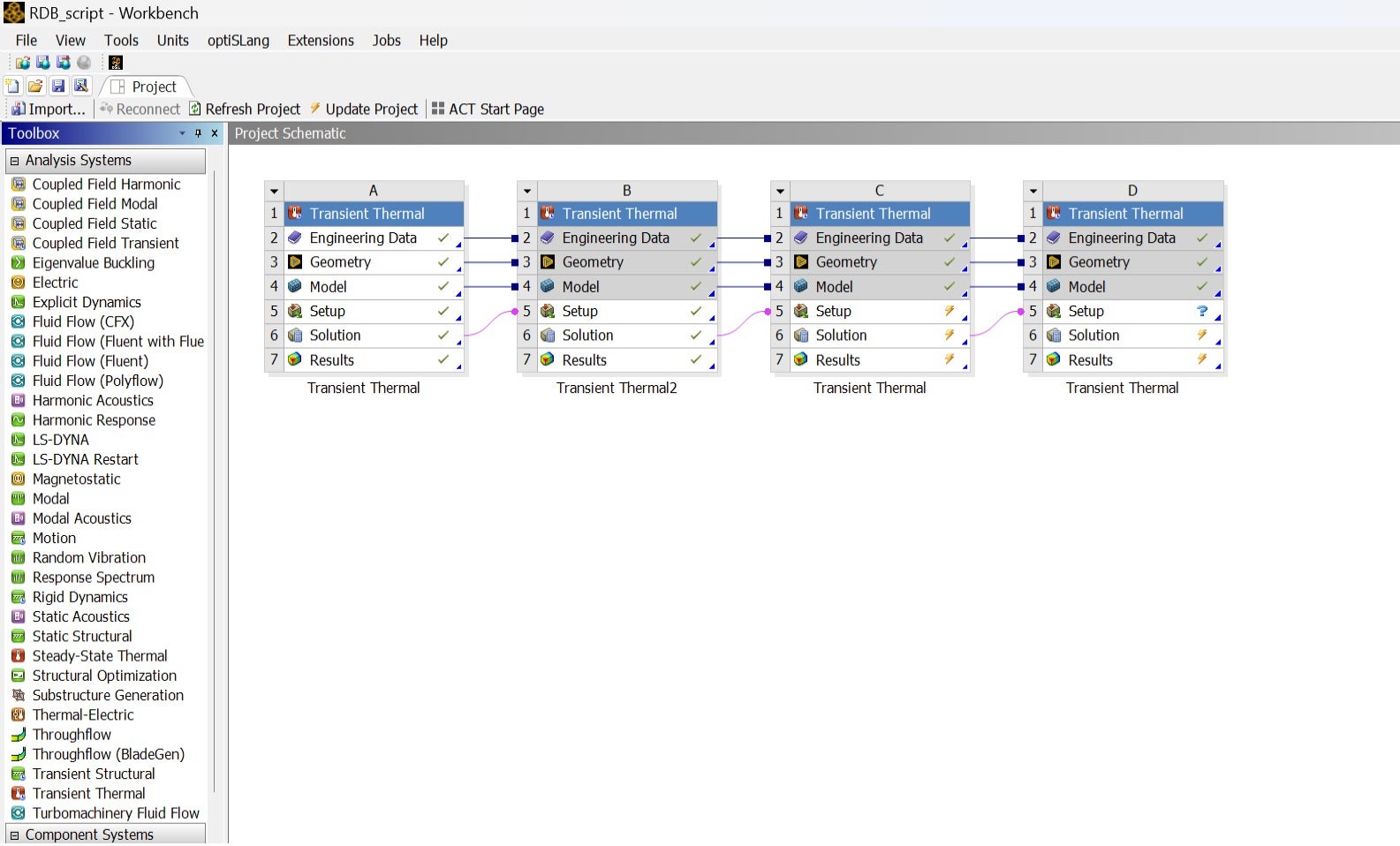

      As i know in this solution after every cycle i should put result temperature as Initial temperature for next cycle (as below schematic)
    • Mohammad.Ali Ghiafi

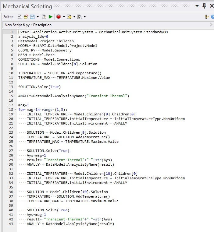

      But if i want to solve this solution i need to make 3500 “Transiant Thermal” in schematic. for shortcut i wrote a script code:
      But when I run this script i recive an error :
      System.InvalidOperationException: Connecting components Solution 2 and Setup 1 will introduce cyclic dependency
      let me know how i can solve with scripting ?
