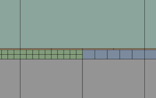

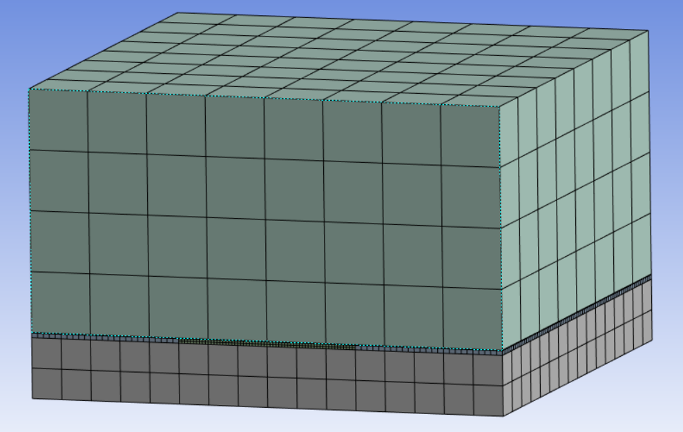

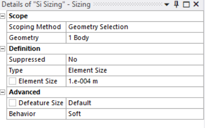

The thing I realized is that under Mesh -> Sizing, there is only Element Size that I could adjust the size of the mesh. And Ansys Mechanical is trying to have the mesh shape close to a cube, which means that the mesh length, width, and height are close to each other if possible. But in my case, my structure is kind of flat. So I actually only need the grid size on the height (z direction) to be small. However, by decreasing the value of Element Size, the gird scales on the x and y directions are also decreased which leads to lots of unnecessary nodes.
So I am wondering is there a way to decrease the mesh size by only decreasing the length of the grid in one direction, not every direction?

Once you have shared topology, all the layers will have the same element density in the plane. Add a Sizing mesh control and have the Geometry filter set to Edges. Pick the 4 vertical edges in one layer and set the control to Number of Elements. Repeat for the other three layers. Now you can control the number of elements in each layer.

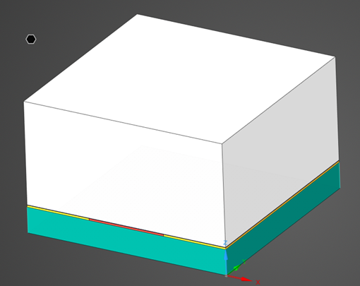

In Ansys Discovery, the modle looks like this:
Different colors represent different material, which means different thermal conductivity. Except the yellow and the red part are the same material but the red part does self heat generation.

If you look top down on a wireframe of the assembly, are there any planes of symmetry in the geometry, materials, loads and BCs? If so, you can cut down the model size by using a Symmetry BC. If all those items are not symmetric then you need a full model.
Please describe the BCs on all faces of the model. If you don't define a BC on the face of the model, it is automatically considered to be insulated (zero heat flux).

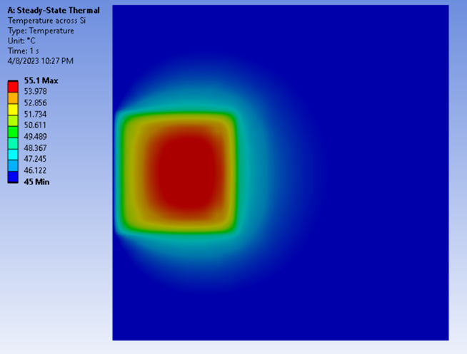

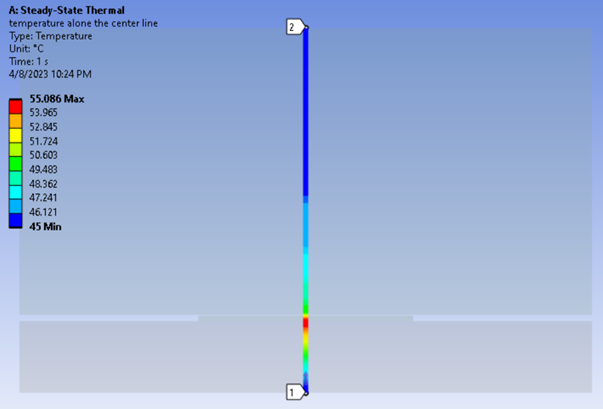

The boundary condition I have here is that all surfaces have the same temperature. So I was trying to see the teamperature difference inside the structure. Such as the temperature of a path that goes from bottom to top through the center of the self heat generation part Or the temperature distribution of a cross section that contain the cross section of the self heat generation part like shown in the images below.

SubscriberThere is one plane of symmetry you could use to cut the model size in half. It is the plane that cuts the image above in half with a horizontal line through the center of the heat generating block. The top half of that image is a mirror image of the bottom half of that image.
