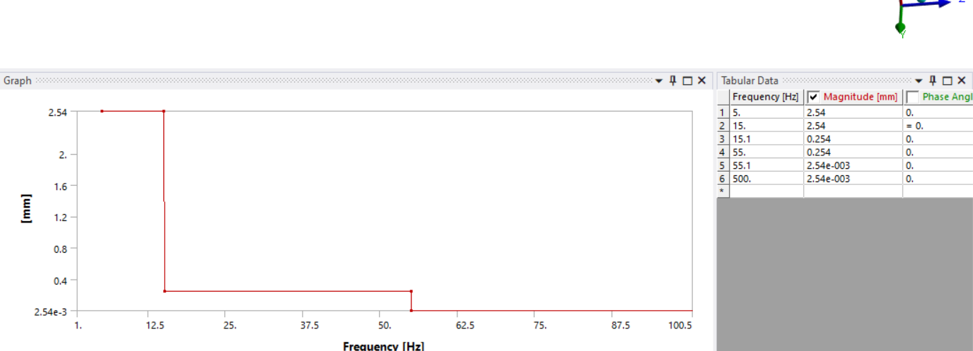

      Hello all , I am performing Harmonic Analysis where my loading is variable with frequency which is in form of following tabular form (Base Excitation). Is anyone have any idea how to give this in ansys Mechanical Harmoic Analysis.

      Did you try using Tabular Data?
    • BALA
      Thanks for your reply, I tried the option you suggested and it worked, the only problem i am facing is the graph is not showing total range.
    • danielshaw
      Please insert an image of the graph and table.
    • BALA
    • danielshaw
      I do not know.  I cannot reproduce that behavior.
