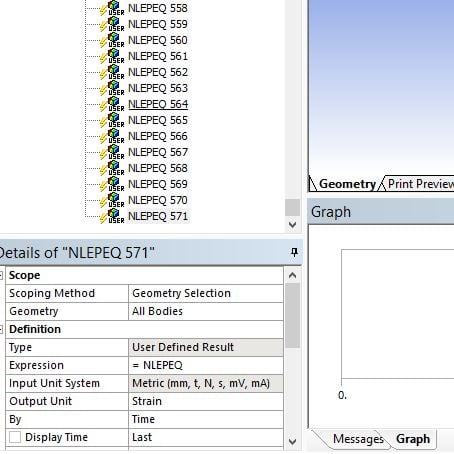

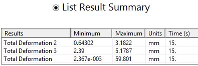

I have obtained my required results and they are showing in the result worksheet. But, I cannot copy them directly. I have many data points and its difficult to copy each and every data individually. I want an easy solution. I am lightly familiar with commands and command snippets. Can anyone guide me?

Forum ModeratorAre you interested in just the values that are shown here in the image? i.e. minimum and maximum of each result at given timepoint?
If yes, you can simply make them as parameters and access them from parameters tab on the workbench window. Here you should be able to copy the data for multiple designpoints as well.

SubscriberYes, I have asked my results in the form of NLEPEQ and NLPLWK...both are maximum at the last time step in the transient analysis. I don't know how to make them parameters, Can you help me guide me through it? Any direct reference is highly appreciated.

SubscriberThankyou and also , how to get different results for different line body when there are many lines. I am tired of selecting each line and scoping it for the results.. as a result I have to duplicate without results and select for scoping for each line body... If this is sorted then my work will be halved. Thanks again

Forum ModeratorYou will have to use some automation such as ACT to do that. Please check:
