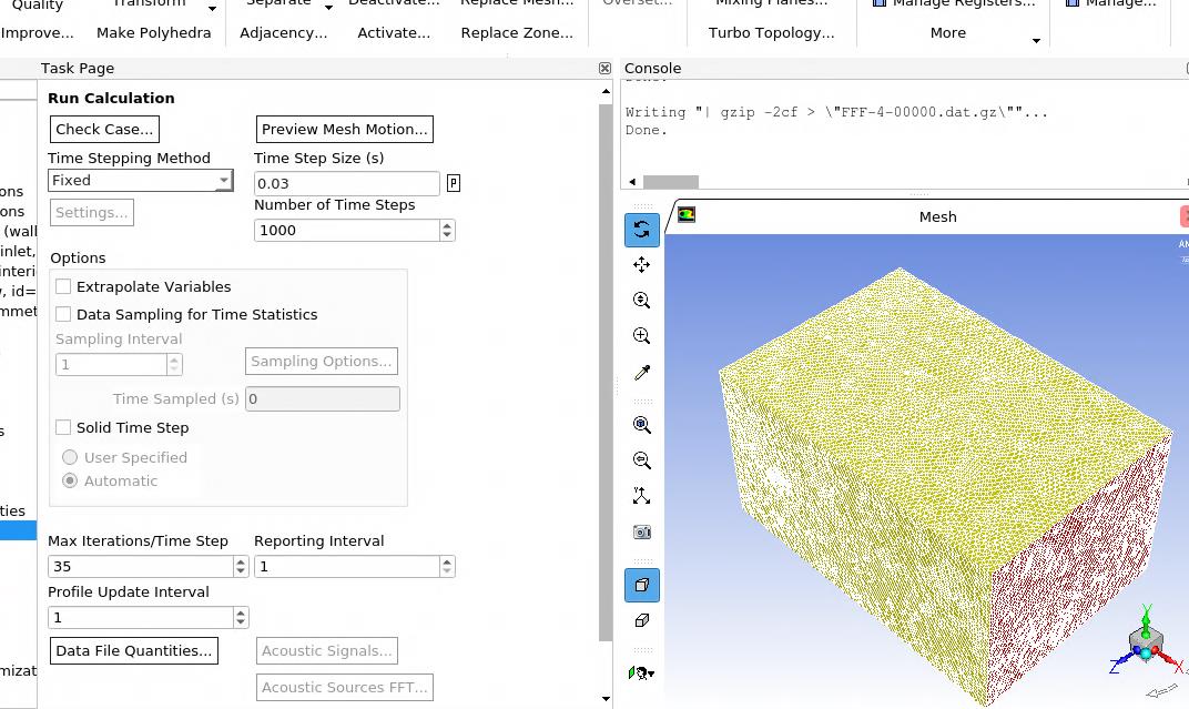

SubscriberRegarding the area, there are 2 ways of calculating Cd, you can chose frontal projection or you can chose the whole wet area. Both are acceptable but obviously would give different Cd values. -

Ansys EmployeeYou can still make force reports on any walls even if coupled to another physics. -

Ansys EmployeeIn Fluent like usual. -
