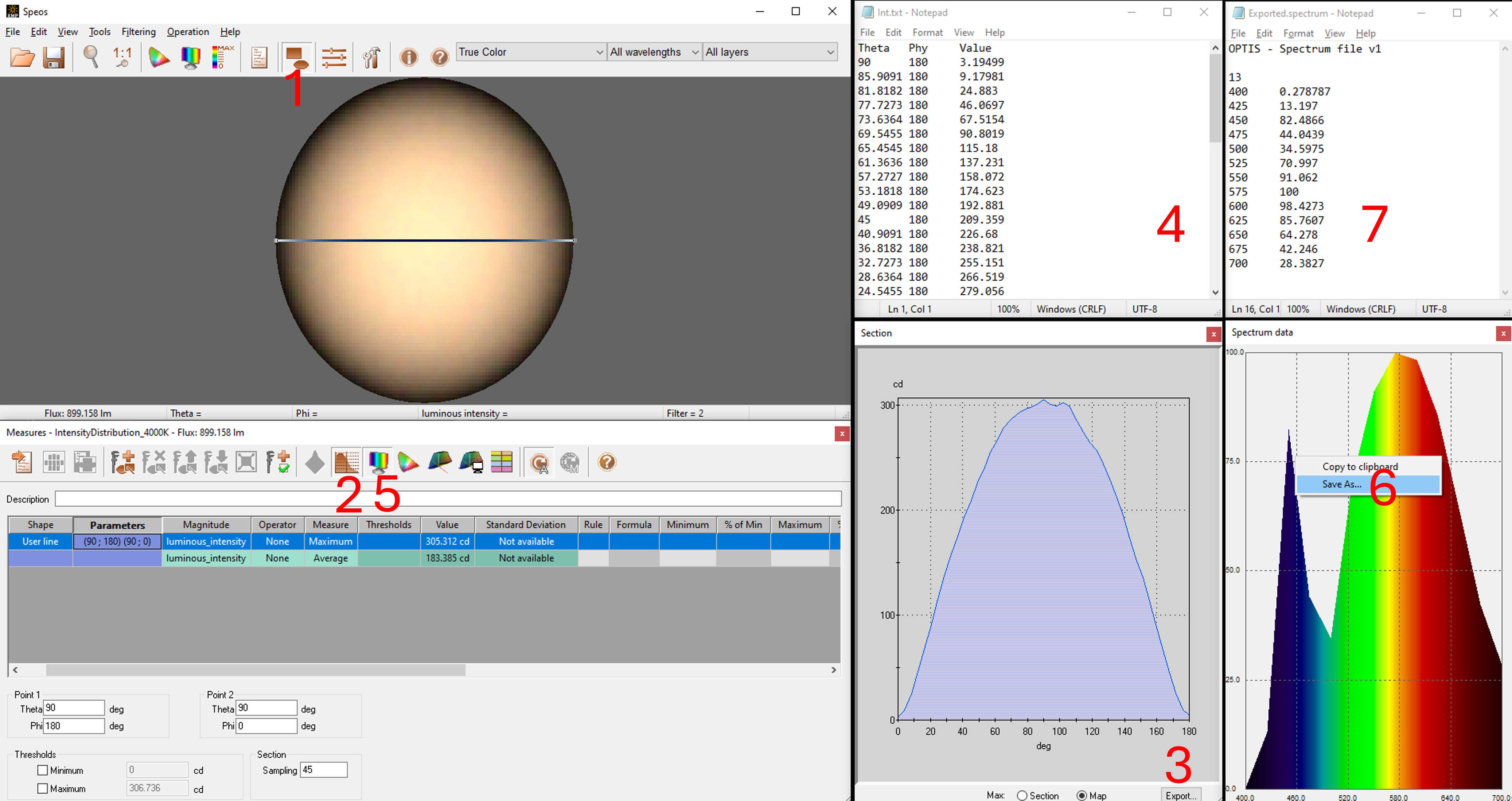

March 7, 2024 at 8:49 pm
nomad
SubscriberHi TAEHYEON,
You can use VIRTUAL PHOTOMETRIC LAB to measure values from xmp result.
Please visit https://ansyshelp.ansys.com/account/secured?returnurl=/Views/Secured/corp/v241/en/Optis_UG_LAB/Optis/UG_Lab/making_measures_analysis_166427.html to check how to use VIRTUAL PHOTOMETRIC LAB.Here is some example steps for measurements, and please contact local Speos support team if you need more help.Â
0. open the xmp file
1. Set measurement profile and adjust it. It's line acrossing the result map in this case
2. You can see value of section from 1.
3. You can export the data to txt file in 4
5. You can check spectrum data
6. Spectrum data can be saved as .spectrum
7. .spectrum file contains wavelength and intensity -
