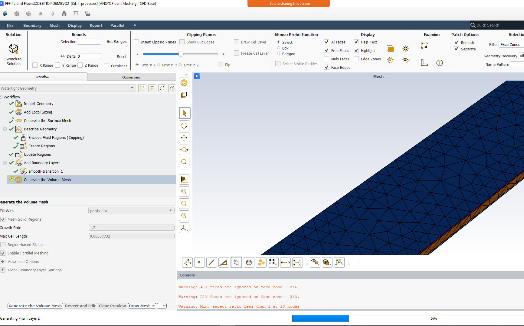

Subscriber I have been going through the " Ansys How To Videos" and been trying to generate a mesh that is high quality, however, I don't see a way that I can generate a good structured mesh when using Ansys Fluent with meshing node from the workbench. I have attached a screenshot of the design that I am getting below. Is there any way to change this to get to a structured design from here?

AdministratorHello Fluent meshing does not generate a structured mesh. A high quality unstructured mesh - yes. Fluent meshing would do a fantastic job. For structured mesh, you will need to use Ansys Meshing in Workbench. Please see the following videos if you need to learn more about domain decomposition and structured mesh (FYI: there are two parts to this video).
