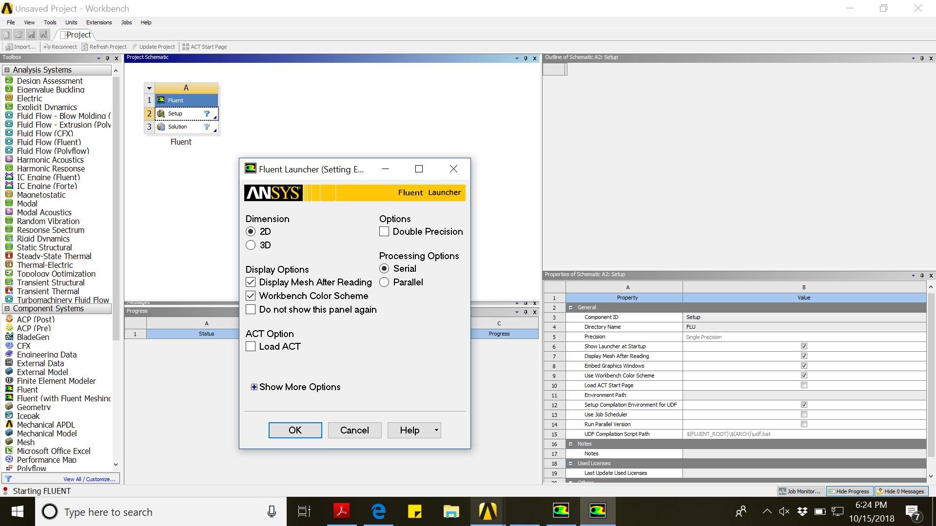

October 15, 2018 at 5:46 pm
raghava
SubscriberHI,Â
 Even I am facing the same issue. I am particularly specifying to run in serial but it starts in parallel. When I compile my UDF , I receive the following error when I try to build the UDF,
"F:trialnext2d_filesdp0FLUFluentlibudfwin642ddp_hostlibudf.dll
Error at Node 0: The UDF library you are trying to load (libudf) is not compiled for parallel use on the current platform (win64).
The system cannot find the path specified.
F:trialnext2d_filesdp0FLUFluentlibudfwin642ddp_nodelibudf.dll "
When I try to load it shows the following errorÂ
** WARNING: Automatically switched to run in parallel -t1 mode. **
** Detected non-parallelized UDF usage, enabling parallel usage. **
** If you encounter any issues, please re-run with -t0 flag. **
****************************************************************************Creating user_nt.udf file for 2ddp_host ..."
How to implement the above mentioned setting with -t0 flag?
I hereby attach the screenshots for your perusal.
Kind regards,

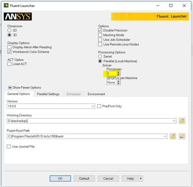

December 3, 2018 at 12:38 pm
ztdep
SubscriberDear sir : i met the same proglem with you. Have you resolve the problem?
December 3, 2018 at 1:18 pm
Rob
Forum ModeratorIf you look at the post by Karthik, you'll note you need to start in parallel with zero nodes: that forces the older style serial solver. However, if you only have one node most UDFs will work as though they're in serial.
