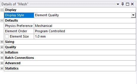

Im facing a problem which did not happen for me in ansys 17.2.
After finishing the meshing I checked the element quality and I was able to find out the quality of element in a blue to red visual way, but once I clicked on the graph of elements in their respective qualities ,The colours disappeared. Now it seems that I have to do the analysis again to view that. I have pressed every possible tool button, but I couldn't fix it.
Here is an image illustrating the issue: -

SubscriberHello peteroznewman I have done that already, the problem is colour representation of the quality of mesh is gone and cannot be put back to its initial state(i.e the geometry changes to solid colour and does not return to the element quality colours) -

SubscriberOn Details of Mesh, the first category Display, if the Display Style is set to Element Quality, it will be overridden by the Quality category where the Mesh Metric is set to Element Quality.
To get the color of the elements back, set the Mesh Metric to None.
