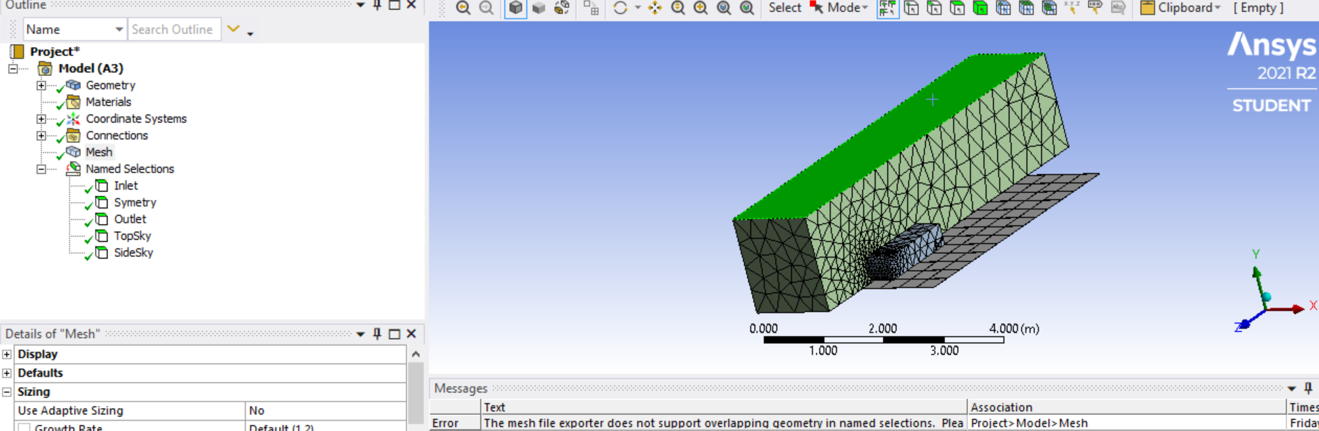

      Regarding the initial title on this post. Initially I had one named selection for the sky, however this gave the error as described in the post. However, after changing the selection to a seperate section, I am still getting the same error. Please could someone provide some advice as to how to fix this?
    • skydownunder
      Try to review your named selections. I also encounter the same issue before and noticed that some faces/objects are included in 2 named selections. After I separate and re-select it, the error was no more.
