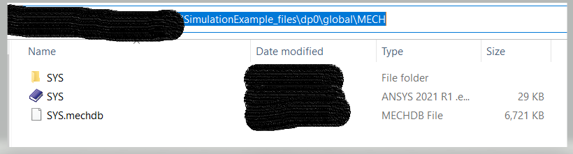

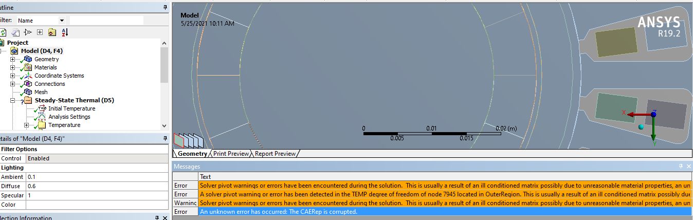

This generally happens when the project is corrupted. Try restoring the model using the Mechanical Database. In Mechanical, exported the .mechdat fie, then reimport into a new object on the schematic.
In your project folder, there should be an SYS.mechdb file for each Analysis object that was on the schematic ( the location for .mechdatis indicated in the error message). - Make a copy of SYS.mechdb to another folder Rename the copy to SYS.mechdatCreate a new Project. File > Import change the extension filter to .MECHDATBrowse to the SYS.mechdatand open. Save the project to a new name/folder when you are done.Also, please avoid having spaces in the file name.Once the .mechdatfile is imported you can resolve or import the result file (if you have it).
