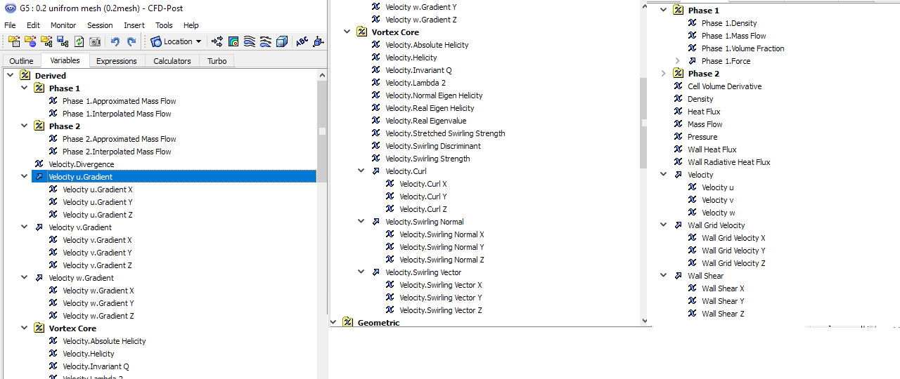

What is the method to get the shear rate in Fluent.
December 3, 2020 at 10:44 amAmine Ben Hadj Ali
Ansys EmployeeShear Rate of what? At what?nShear Rate is a quantity which can access for Contour Plots, Report Expression or UDF'snDecember 3, 2020 at 12:54 pmDecember 3, 2020 at 1:26 pmAmine Ben Hadj Ali
Ansys EmployeeCheck the variable under Derivatives Category.nDecember 3, 2020 at 1:35 pmDecember 3, 2020 at 1:47 pmRob
Forum ModeratorNot all data is transferred from Fluent as some is calculated as needed. Have a look in Fluent, and you may need to add it to the data export. nDecember 3, 2020 at 3:30 pmDecember 3, 2020 at 3:54 pmAmine Ben Hadj Ali
Ansys EmployeeDo use CDAT Export and select strain rate or better to do post-processing in Fluent. Shear Rate is the Strain Rate. nDecember 3, 2020 at 3:55 pmTareq
