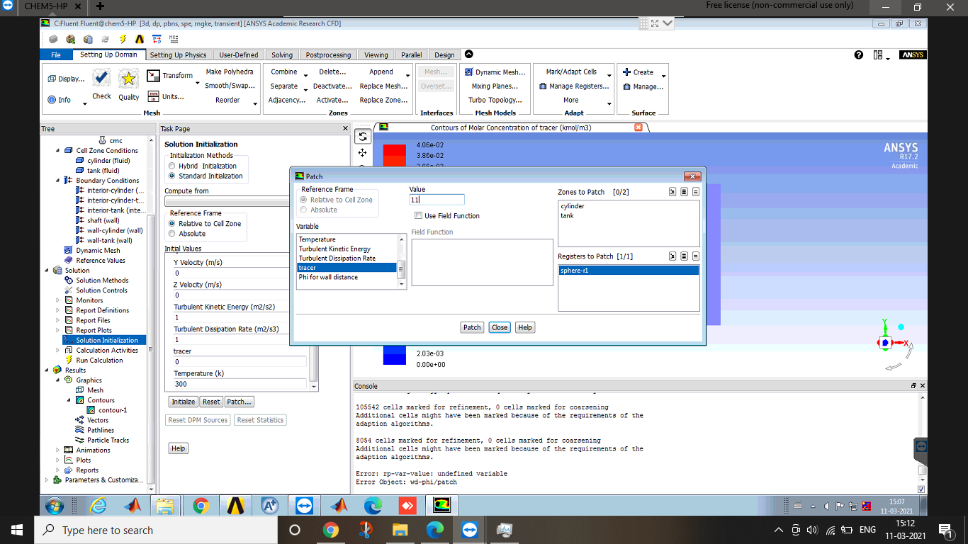

SubscriberHello all!,nIm working on my final year project: Mixing of non-Newtonian fluidsnImpeller: Rushton Turbine 180 rpmnI need to calculate the mixing time using using racer. This is the method im doing:nSet up steady flow with fluidnDefine UDSnMake the flow transientnSwitch off flow, turbulence and switch on UDS scalarnMark the region nPatch the region with the UDSnReport definitions: Vertex average of UDS scalar at different pointsnRun the calculation for time step size 0.01 and number of time steps as 10000nHowever the results I get are weird. Im aware of getting the concentration Vs time curve at different points.nPlease help me out!n -

March 11, 2021 at 10:11 am
March 11, 2021 at 10:32 am
Amine Ben Hadj Ali
Ansys EmployeeMass Fraction cannot be larger than 1. Patch it to 1.nAlso please think about updating to a supported Ansys Fluent version.n -
