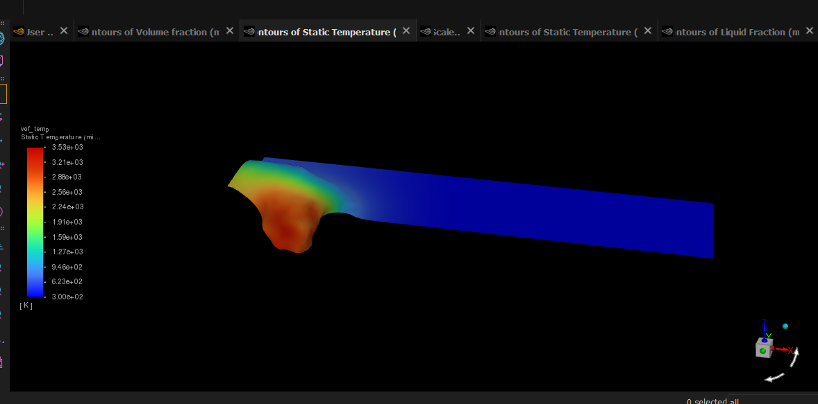

      Objective
      I am working on modeling ray-tracing using User-Defined Functions (UDF) in ANSYS Fluent as part of a laser welding simulation. The ray should reflect based on local surface orientation and deposit energy accordingly.
      Primary Question
      I need help understanding:
      a. How to perform a local cell search?
      I understand that DEFINE_SOURCE executes for all cells in the domain.
      However, in my case, I need to perform a cell-by-cell ray propagation, which effectively requires a nested cell loop:
      • For each cell, I want to trace a ray forward in a given direction.
      • The ray should traverse through neighboring cells until it hits an interface.

      Staff can't go into too much detail, and I'm not debugging code.  Part of your problem is that the free surface isn't a facet or surface in Fluent, it's just a different material in the cell, so finding a normal may be more complicated. However, is the cavity full of molten liquid or are you vaporising the "solid"?
    • rakibul.buet19
      Thank you for replying. You don't have to debug any code. I just put it there for context. No, I haven't included any evaporative mass transfer mechanism. It's just a two phase VOF simulation, Air and metal phase (can be solid or liquid depending on liquid fraction value)

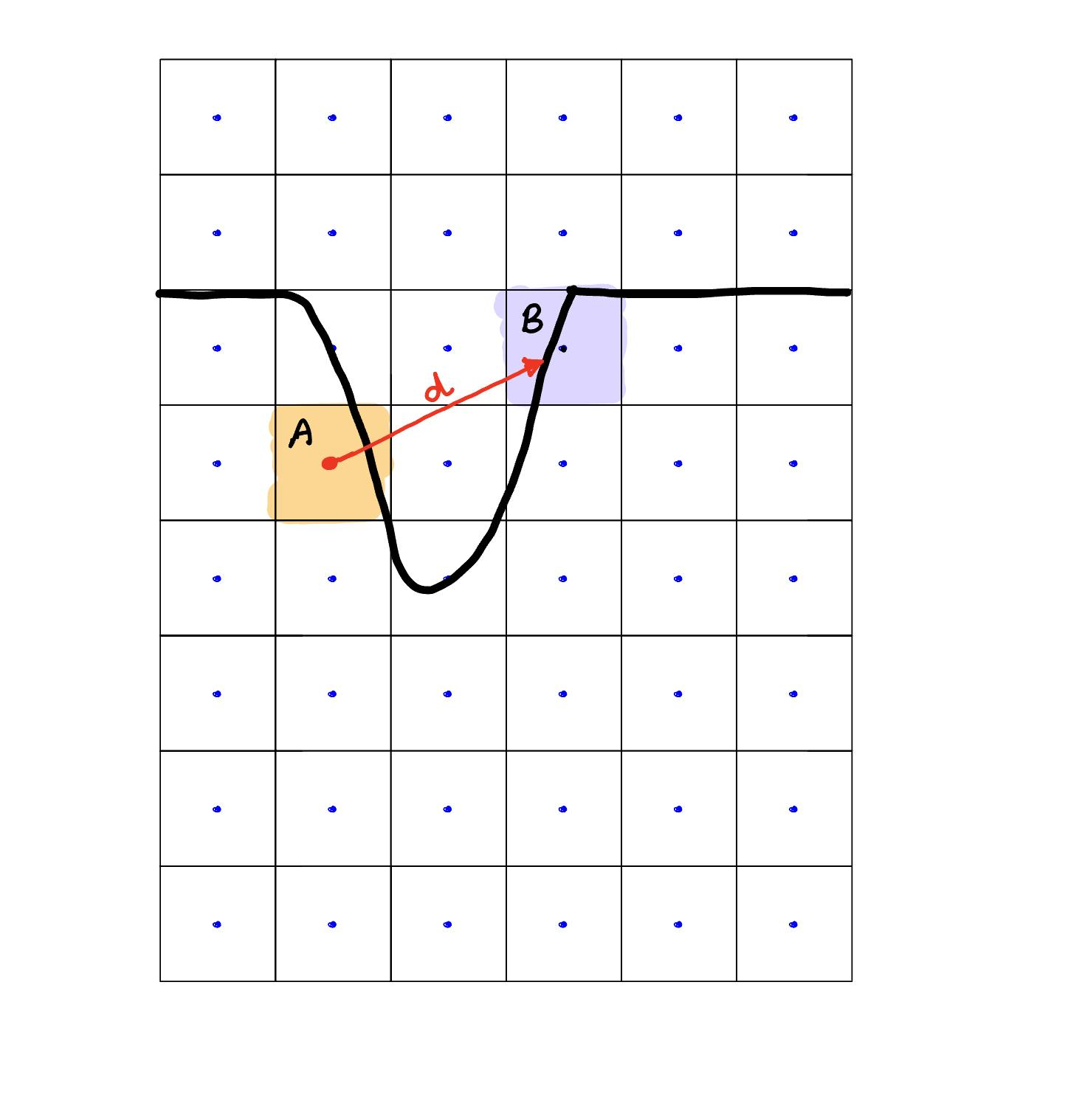

      Let me make the question more clear:
      Suppose I am at Point A, I know the distance d. I want to know the cell-centroid of the cell at Point B.
      So what I am asking is, can i do a sequential search of neighboring cells one by one and approach point B gradually? is there any way to do that?
      Looking forward to your reply Rob!
      Here is an illustration :
      There will be, but I know from others who have done this that's it's not standard code. You can search around neighbouring cells: cell A has bounding facets, and you find the cell on the other side of that facet, then move on from there. It won't be efficient, and there is likely a better way of doing this.

      I think you’re talking about this one right? Adjacent Cell Index ( F_C0, F_C1):   Rob - link removed, use the one I posted.
      Yes, but use the proper documentation and not the ancient copy that's floating around   https://ansyshelp.ansys.com/public/account/secured?returnurl=/Views/Secured/prod_page.html?pn=Fluent&pid=Fluent&lang=en  Macro's and the like do occasionally change.
