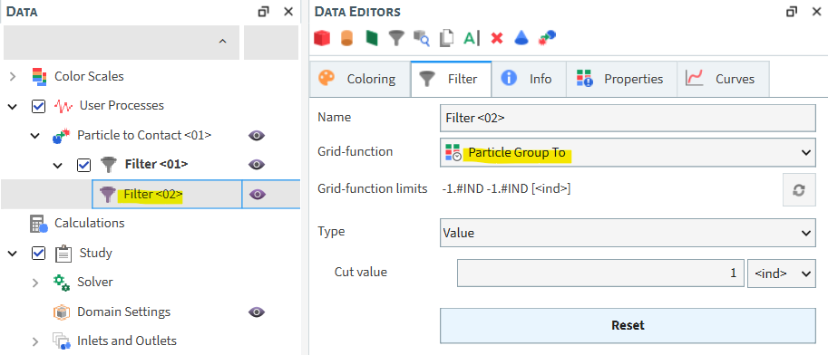

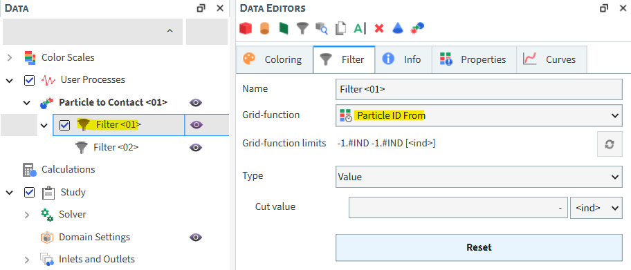

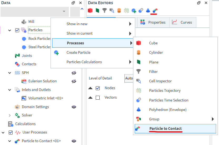

      Ok, I'm going to show you another workflow, see if this is what you mean.
      We can use the "Particle to Contact" User Process to analyze particle/contact properties.
      Now, we can use an association of filters to identify the pair of particles for a given contact event. For example,
      Let's create a Filter process upon the Particle to Contact process. In this fiter, we can select "Particle ID From" to define the first particle of the contact pair.
      Now, upon the "Particle ID From" filter, we are going to create another Filter. For this one, we can select the "Particle ID To" property.
      It should look like this.
      Now, all of the properties from the second Filter are those of contact pair between particles A and B, for example.
      To know their positions, then you'll have to use filters and ID's to evaluate a certain particle at a given time and extract that information.
      Please, let me know if this is what you are looking for.

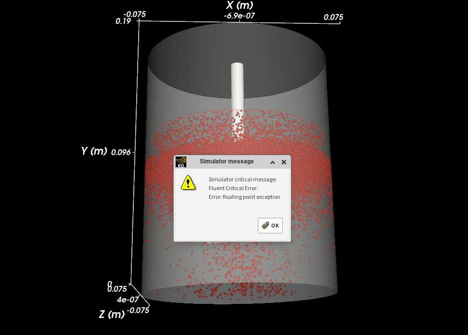

      I am studing the CFD-DEM coupling tutorial 16. I did run the fluent stop and write out both case and dat files. Setup the Rocky part. However, when i started the simulation, I only saw the rocky simulation summary no new dialog for fluent coupling. And as the simulation is runing, I don't see any evidence of fluid in my system. I am running all on a super computer. No error printed but I can't find fluid in the simulation. After running for some time I get this error found on the attached image
    • Lucas Hoenicke
      This error doesn't explain much : /
      What version of the manual are you accesing?
      What version of Rocky and Fluent are you using?
      Is it Student package?
      Are you trying to run both Rocky and Fluent on GPU?

      I am using version 2025R1 for both Rocky and fluent. It a paid version my school subscribed to it. I am running on a cpu in the school supper computer. Both Rocky and Fluent are install on the supercomputer
