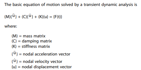

The analysis I am trying to perform is a full transient simulation. I don not understand why it would be necessary to perform a modal analysis, if transient simulation basic solves equation above, which is mass dependent.
