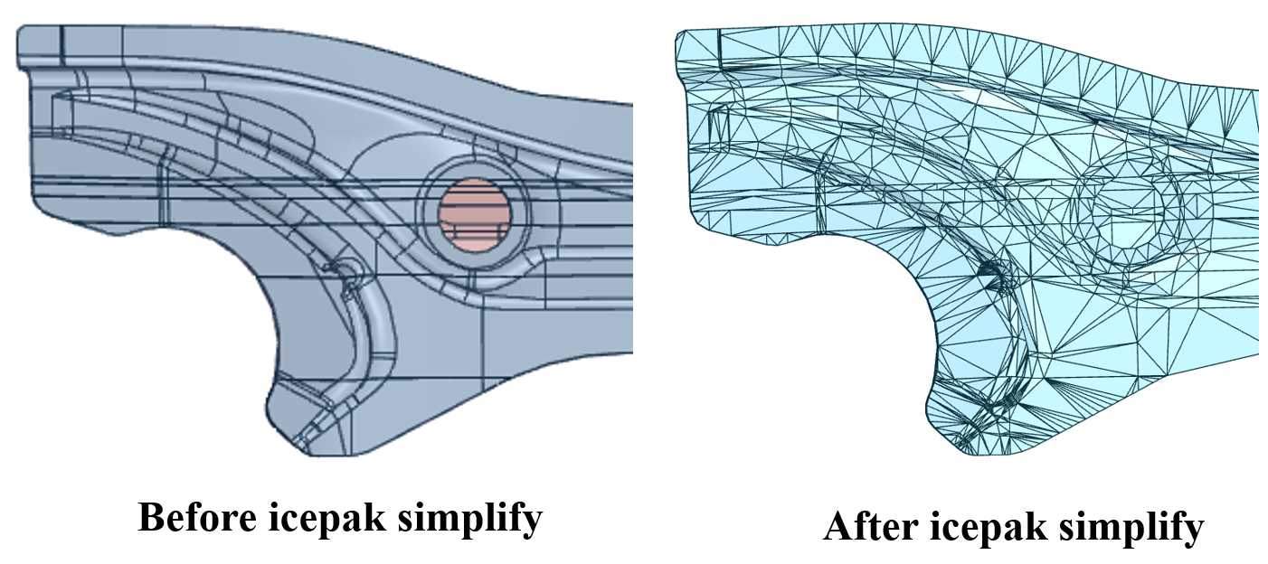

Thus, in the process of simplifying cad models in several 3d design programs, I found icepak simplify of spacelaim.
This is the best simplification of my cad model, and I think it can be possible to CAE analysis.
As far as I understand, icepak object seems to have another purpose, so can't i just save it as cad object instead of using it for that purpose?
(I would like to apply the shape as shown in the picture above - after icepak simplify)

As mentioned earlier, if it's the above shape, I don't think there will be any errors during the Fe analysis.

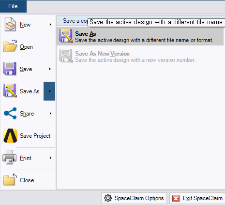

However, every time I export  Icepak simplified geometry from spacelaim, the file before performing icepak simplify has been saved. (Step, Parasolid, ACIS...)
Therefore, I would like to know how to save the above icepak simplified geometry as CAD formats like STEP or Parasolid.
