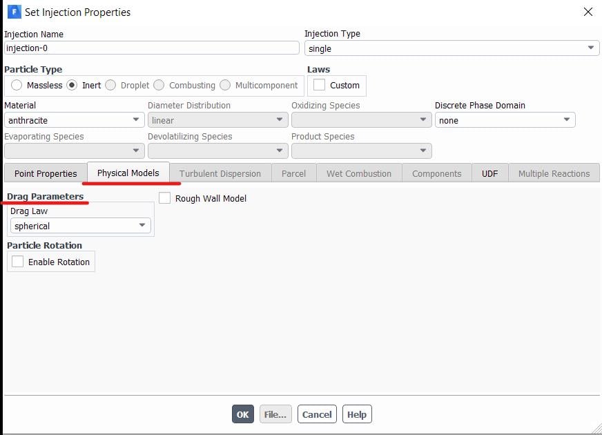

      Hello everyone,
      I'm trying to simulate the dust disposition on a PV panel using ANSYS FLUENT, to do that I'm using the discrete phase model.
      in the article that I'm trying to validate with, said that:
      << In this study, total five dust particle forces were considered in the simulation: the drag force, the gravity force, the buoyancy force, the Brownian force and the Saffman's lift force >>
      I only found how to enable the Saffman's lift force in the discrete phase model as shown in the picture below.
      can someone of you please show me how to enable the drag and the Brownian forces...
      I truly appreciate any comments or answers from you

      The Drag parameters tab can be found in the Injection properties window, under Physical models
      The Brownian motion option is available only when the Energy equation is enabled and Stokes - Cunnigham drag law is selected. For more information, please refer to the following link.
      https://ansyshelp.ansys.com/account/secured?returnurl=/Views/Secured/corp/v201/en/flu_ug/flu_ug_Set_Injection_Properties.html
      Rahul

    • Rahul Kumar
      You can find it in Fluent User's guide. If you are using the Fluent 2020 R1, you will find it in Fluent User's guide --- Solution mode --- Chapter 48.2.89.
