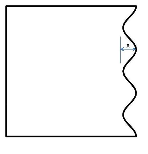

      I am trying to draw a wavy wall in an enclosure using DesignModeler with a fixed amplitude A as shown in picture? may somebody guide me how I can do that?
      Look up line import options (Concept Modelling) and also pattern.
    • khalidb77
      Do you mean importing the geometry? may you sent illustrated picture for the option?
      Yes, generate the line as points in Excel and import as a line: check DesignModeler documentation. You can then pattern the line or whatever you make from it.
    • khalidb77
      But I do not have data for the line ? how I can create it in Excel?
      You have an equation for the line?  Otherwise you'll need to sketch it in DM, if you don't know the shape/coordinates how do you plan on doing that?
    • khalidb77
      Yes I do not have the equation for the line. How I can draw a wavy line in DM? This is my main question? I have the coordinates and dimensions of the configuration.
      If you have coordinates you can either create (and dimension) construction points in sketch, or read up on importing line bodies.
      Please reply with the coordinates and dimensions of the configuration.
      You can put any file type inside a zip file archive and attach the zip file after you post a reply.
    • khalidb77
      Many thanks I able to plot the geometry with creating intersection points then use spline I got the below mesh. Now I want to make inflation at the right and left walls but I failed to do that and the inflation never activated?
