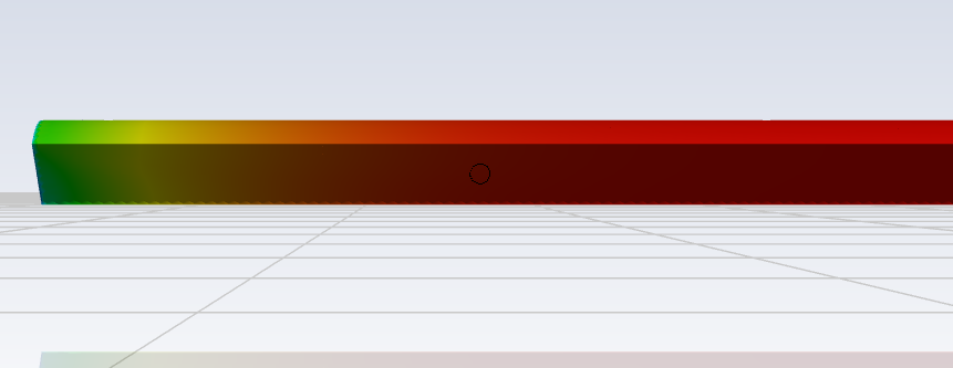

      Hi guys,
      I had a small doubt after executing my solution, while viewing the contours, is there any way I can see the distance of a particular cell from the starting or the end of the mesh. For eg. In the picture below -
      Assuming you're in Fluent, use the Surface>Create>Point and click onto the contour. No need to actually create the point, but it'll put the coordinates into the panel.
