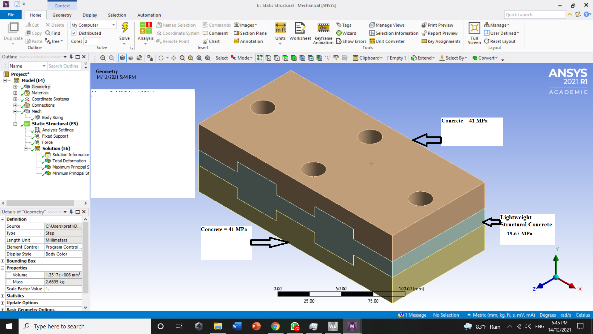

SubscriberHi I have designed a sandwich concrete brick consisiting of Structural Lightweight Concrete sandwiched between normal Concrete. How do I determine the compressive strength of concrete? Your help will be very much appreciated

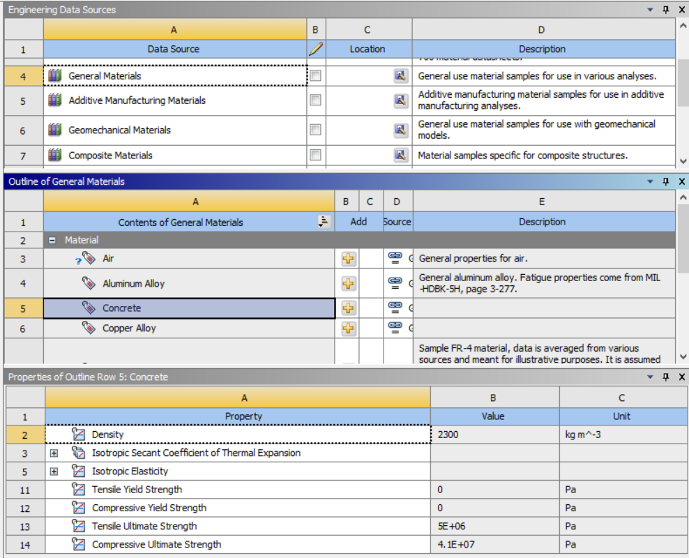

You can find the Compressive Yield and Compressive Ultimate Strength of a Material in Engineering Data Cell of Static Structural Analysis. Since concrete is a brittle material you will need to use the Compressive Ultimate Strength.

SubscriberI need to find the compressive strength of the whole brick not the material not the material only. By the way is there a way to find out the failure load of the brick?

For the first question, you can find the compressive strength from the available data on the internet or test the material. For the second question, a Finite Element Solution with Safety Factor Result, under Stress Tool, can be used.

Since concrete is a brittle material, you can use the Maximum Tensile Stress Safety Tool or the Mohr-Coulomb Stress Safety Tool. In general, the selection of the Tool will depend on the expected mode of deformation- if only tensile stress is subjected, then Maximum Tensile Stress Safety Tool can be used whereas if compressive stress is also involved then Mohr-Coulomb Stress Safety Tool should be used.
