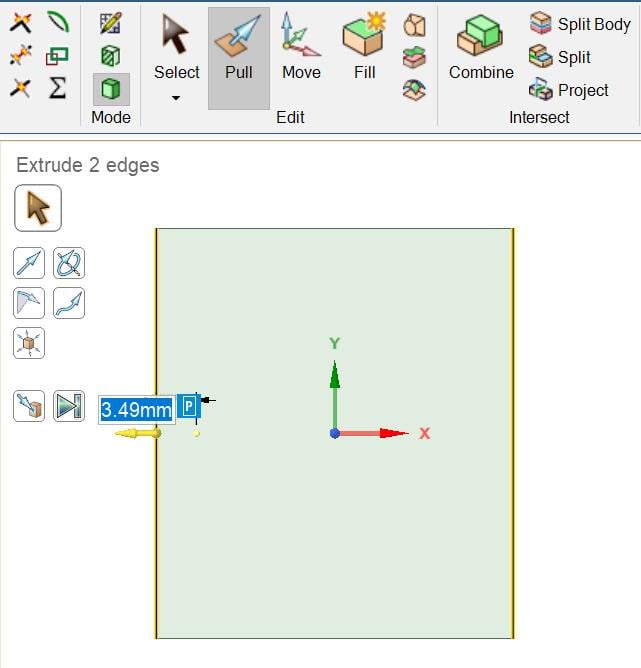

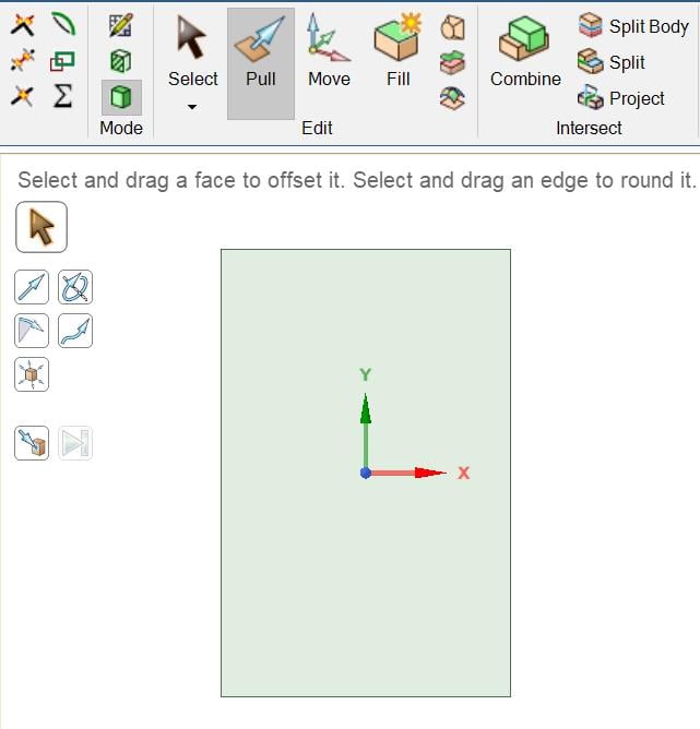

SubscriberSpaceClaim's strength is solid modeling, not drawing. If you convert a rectangle of curves into a surface, then you can adjust the size of the rectangular surface and maintain the center of the rectangular surface at the center.
Pick the two edges using the Ctrl key to add the second edge, then pull to make them move symmetrically.
