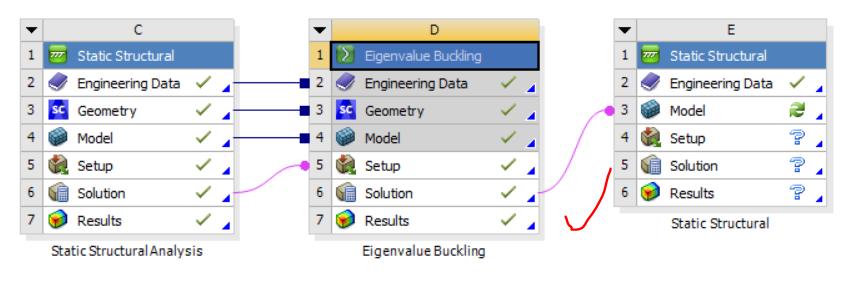

after making a Eigen Buckling Analysis I want to update the geometry of my model with the deformation model of the fifth mode. How can I do it? I already know that I must use the command UPGEOM, but I don't know **** to select the mode of deformation which I refer to. I use Mechanical APDL. Thanks.

You can directly link the solved Eigenvalue Buckling analysis Solution to the model cell of the Static Structural analysis to have the deformed mesh.

For having the complete deformation for mode 5:
/prep7
upgeom,1,1,5,buckling,rst
finish
