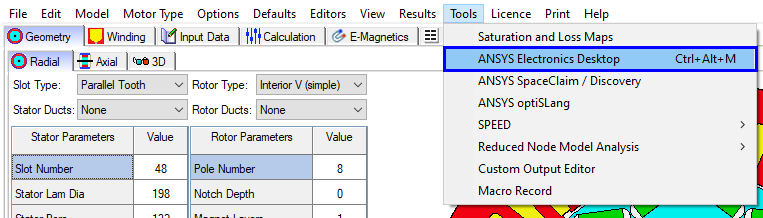

Subscriberi want to use geometry options in motorcad and transfer this data to the same machine in maxwell.
is it possible to transfer some data from motorcad to maxwell?
August 28, 2023 at 2:31 pm
Ivonne Marti
Ansys EmployeeHello Ali Yousefi,
You can export the MotorCAD design including geometry, materials, windings and magnets (where required) and some results for solving will be created automatically in Maxwell.
To export the model from MotorCAD to Maxwell, please go to Tools / ANSYS Electronics Desktop (see image below). Ivonne
