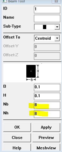

      Very confusing, because you do not specify which mesh you talk about and you are not aware how beams are used in an FEA software.
      I think you talk about the cross section mesh, but normally when people say mesh they mean along the length of a beam, and not the sectional mesh (which is used by the solver for NL calculations, stress calculations and showing results).
      That is changed at the cross section level, thus it can be done when you define the cross section. See below how that can change from a default of 4 (2X2) elements for a square solid beam to 8 X 8 elements .

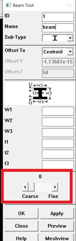

    • wh05
      Thanks. yes, I am talking about the cross section mesh. But your example is concrete beam. Should I adjust the "coarse and fine" for steel I beam?
