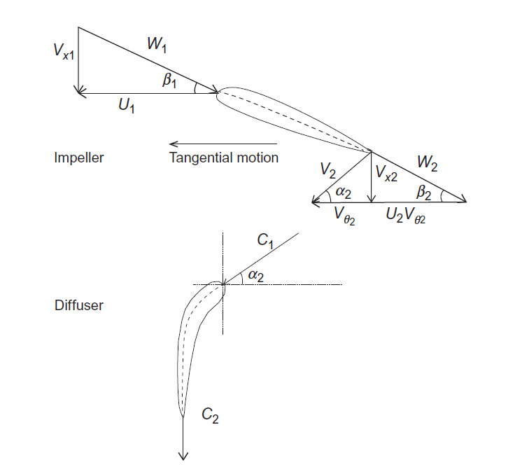

I am using cascade notation for the design of an axial impeller. The 3 parameters are - beta1 (impeller inlet angle), beta2 (impeller outlet angle) and chord length of impeller. How do I convert these to make a BladeGen model?
I have attached a picture of the cascade notation.

Ansys EmployeeAssuming you know the axial blade chord and inlet, outlet beta angles for the blade with respect to the axial direction, you can directly create a BladeGen model using those values:
1.) Drag BladeGen from the toolbox onto the WB project schematic and double-click to open BladeGen
2.) Go to File->New BladeGen Model
3.) From the Initial Meridional Configuration Dialog Box, select Simple Axial. Set the axial chord by adjusting the leading edge and trailing edge Z values in the input boxes.
4.) Using the default mode (Prs/Sct), set the leading edge and trailing edge beta values in the input boxes.
Once in BladeGen, you can adjust/change the model as needed
