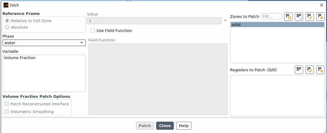

As a tip, use /file/read-case ie always use the full command with the / character to ensure Fluent uses the full command.Â
Looking at the command, in the Fluent TUI type in solve and look at the options, pick Patch and hit enter twice again to see the next level of menu. Chances are you’ve missed a phase or zone label in the command.Â
One final comment. I’d suggest saving case & data when running, and maybe decrease the save frequency unless you’re doing to this to post-process data. Every time time is a little excessive!Â

SubscriberReally thanks for your reply.
Could I know full command of the above example?
