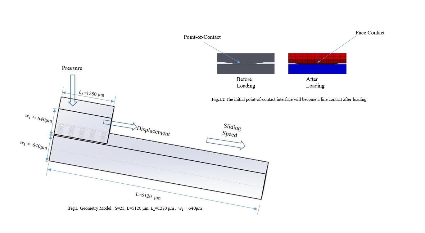

Hello everyone,
  Can anyone help me to calculate the contact area after deformation in the Transient Structural Analysis?
As shown in the Figure 1, the length of the body1 (slider) is L1=1280 μm, the length of the body2 (fixed) is L= 5120 μm, breadth of the both top and bottom bodies is w1 = 640μm the maximum peak radius of the peak is r=80 μm respectively and surface peak apex (s) =25, sliding speed v=1.024 m/s, height of the peak is 100 μm and difference between the peaks is 0.256 μm.
Pressure is applied on the top surface of the slider. Displacement is applied on the one face of the slider. Fixed support is applied to the bottom surface. In the simulation, the upper slider is set as the follower, and a uniform pressure (P) is received in the y-axis direction, the sliding speed (V) is given in the x-axis direction, and the lower slider is set as a smooth flat fixing member.
When the upper and lower sliders are in contact, the upper slider is in contact with the smooth surface of the lower slider by the rough peak, and the upper and lower sliders generate heat due to friction when the relative motion is performed and the heat is concentrated on the surface portion of the peak contact. And the surface of the wave is transmitted to the surroundings and the interior.Â
In this, we will analyze the change of the contact surface of the upper slider and the internal value of the contact peak.

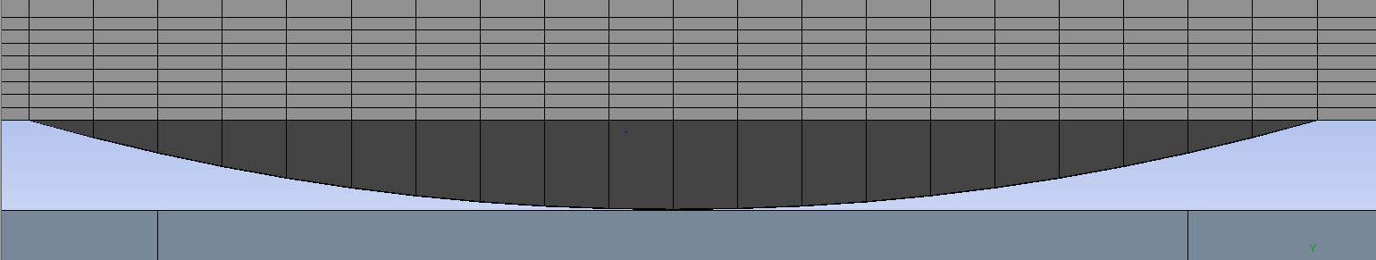

                                           Figure.4 Before loading Contact area status
As shown in Figure.4, Before Loading the contact status is point contact, it’s radius is r=80 μm and it’s height of the peak is 100 μm and after loading the contact status is face contact after deformation as shown in below Figure.5.

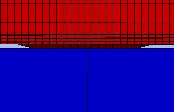

Figure.5 After loading Contact area status
How to calculate the contact area after deformation.Â

Subscriber" alt="">Â Fig.1Â Conatact GapÂ
" alt="">Fig.2 r=80 μm ,h= 8μm.

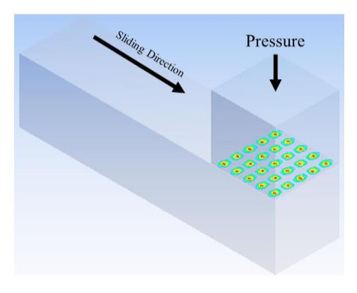

July 4, 2020 at 1:31 pmpeteroznewman
SubscriberExport the contact pressure results including the nodal coordinates.
In matlab, contour the zero pressure boundary, then measure the area within the zero pressure contour.

Subscriber The list above is useless. You must export the pressure with Nodal Coordinates. Please insert an image of the Pressure plot from Mechanical with the elements visible.
