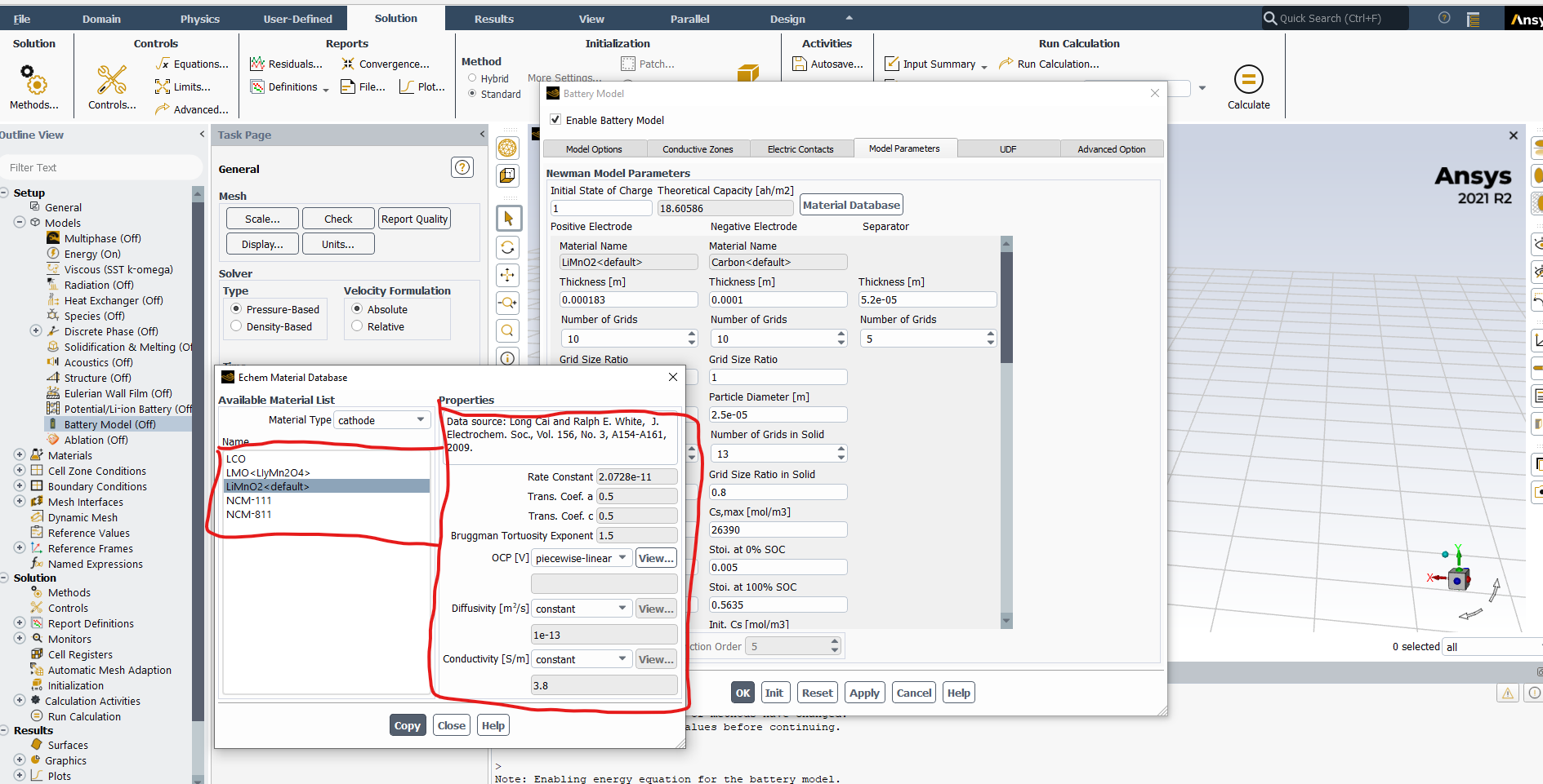

March 23, 2023 at 3:58 pm
Jon Lees
Subscriber -
April 14, 2023 at 11:53 am
Murari Iyengar
Ansys EmployeeHi Jon Lees, You can add/edit materials using the Scheme file. The materials database can be found here:
.....fluent\fluent\addons\msmdbatt\lib\echem_database.scm
- The topic ‘How to change material properties in the Echem Materials Database?’ is closed to new replies.
