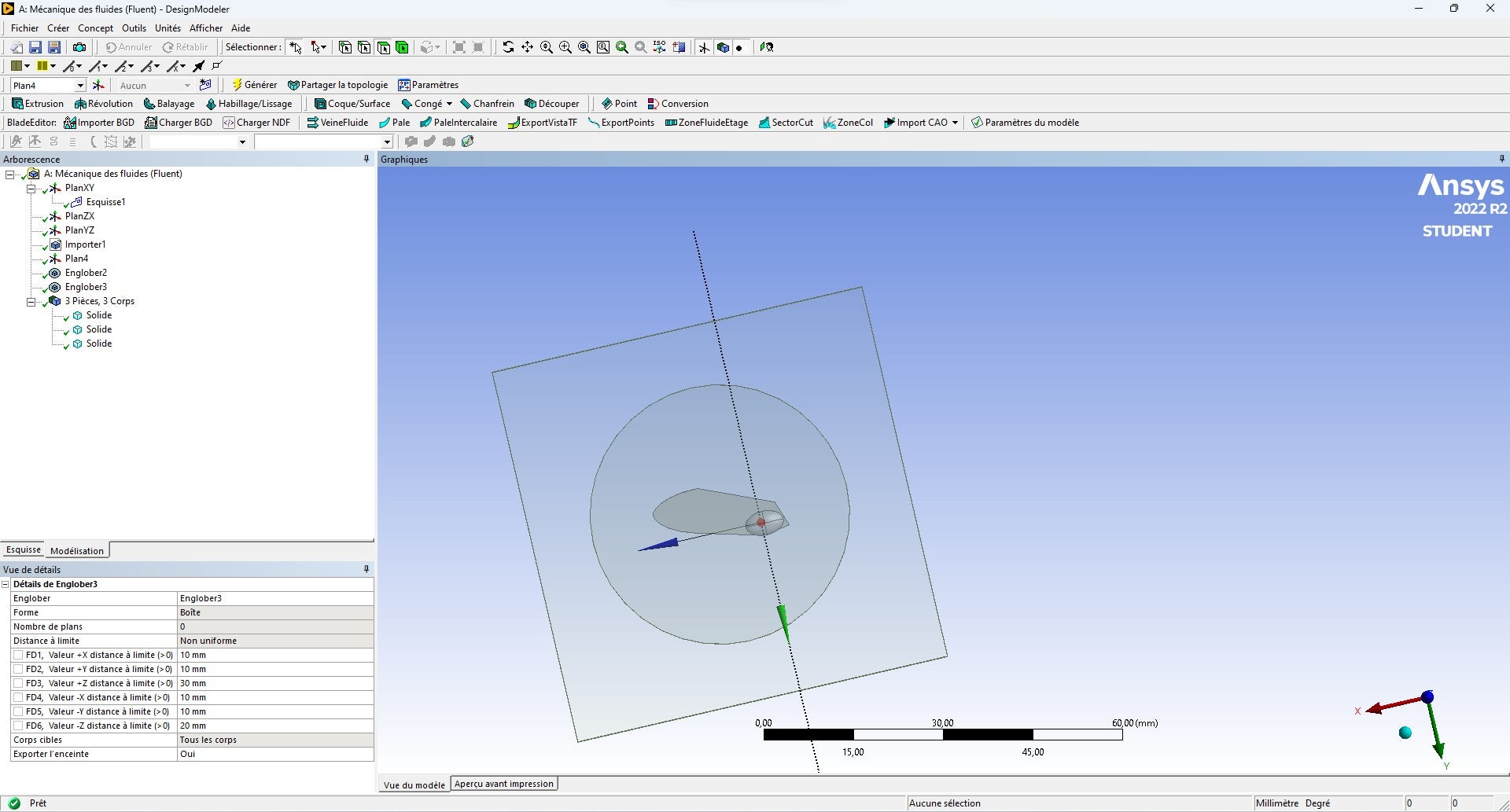

Select the Enclosure, in the Details panel under the Location section you can click on the Locate Enclosure and select the Reference Point option to enter the X, Y, and Z coordinates of the point on your wing that you want to use as the reference point.

Ansys EmployeeHello,
It is not recommended to move the enclosure once it is generated. First try orienting your wing model to the origin or with desired dimensions and then create the enclosure domain. The model can be oriented by using body transformation options under the Create tab on the Menu bar.
Additionally, I would encourage you to use Ansys Discovery for better designing experience.
