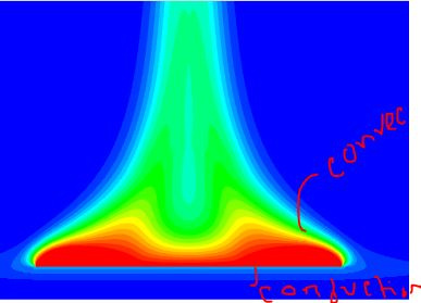

SubscriberI am simulating a heated droplet impacting on a surface in 2D asymmetric model. The droplet transferring heat to the surroundings by convection. How can I calculate the convective temperature loss from the droplet surface.
I tried to calculate by creating an iso-surface for of droplet-ambient interface. But the interface is not giving the real temperature.

Ansys EmployeeYou can monitor the temperature in the volume occupied by the droplet or at least area-average of the temperature at the iso-surface VOF=0.5nAugust 6, 2020 at 8:05 amrumth
SubscriberI did area average temperature but not getting the expected temperature because in 2D, iso-surface is actually giving a boundary line of droplet. Are there any way to calculate the temperature of whole volume fraction of droplet?nAugust 6, 2020 at 11:18 amAmine Ben Hadj Ali
Ansys EmployeeNo: You should at least use 2D-Axis to model a correct droplet.nAugust 7, 2020 at 1:31 amrumth
SubscriberSorry for using the term 2D in the above comment. Actually, I have used 2D asymmetric to model the droplet. In this model, iso-value of liquid is actually giving a interface which is not providing actual temperature.nViewing 4 reply threads- The topic ‘How to calculate convective temperature loss from a surface.’ is closed to new replies.
