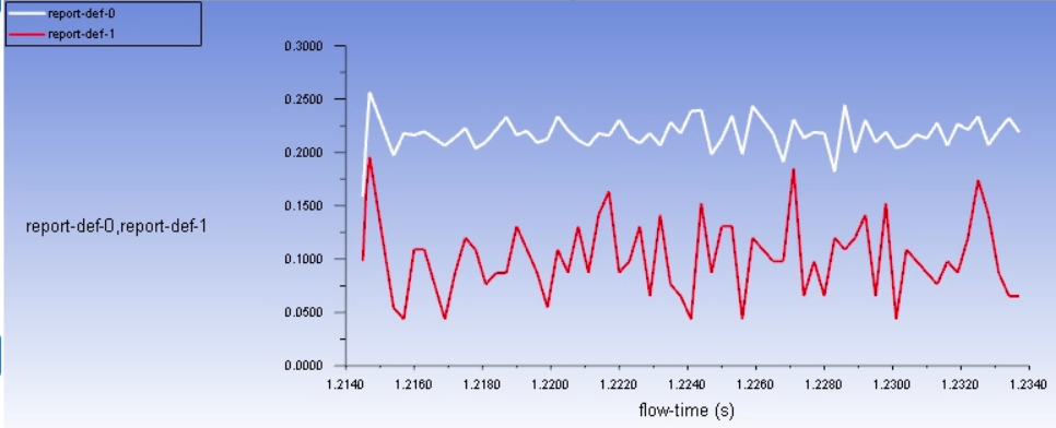

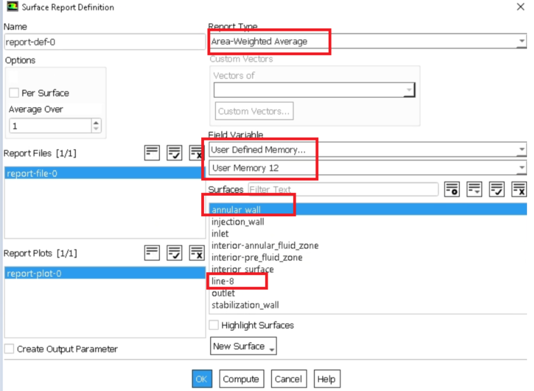

1/Will you check the area-weighted average report definition(below image)? I am trying to simulate annular flow in a 3D pipe. I selected the ANNULAR_WALL(outer pipe surface) as the surface. As it's a transient case, it's reporting a plot of area-averaged variable vs flow-time.
2/I also created a line(line-8) along the wall(axial direction) of the pipe. Should I select line-8 or Annular_wall as the surface during reporting area-weighted average?

Forum ModeratorCheck the values once you've initialised the solution, I can't remember if lines have an area or not so the solver may return zero. For an area weighted average v time you need to use a monitor to save that data to file every time step. The data files in Fluent store the instantaneous values only (ie for that time step).

1/It's showing the plot for both cases. A white line for annular_wall as surfaces and a red line for line-8(a line on the wall in the axial direction) as surface. So, which one is accurate and logical?
2/Yes, it's showing a graph between area-weighted average vs time(flow-time) but I need to plot area-weighted average vs axial position at the end of the simulation. How can I plot this?

Forum ModeratorBoth are doing what you told them to. You are reporting the area average of a line (or surface) against time. If you want the time average value at points along the axis with time you may want "hoops" and will have several surfaces. Be very careful with your definitions.

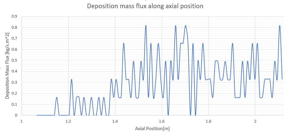

August 21, 2021 at 6:44 amAnadi_Mondal
Here I average local values( deposition mass flux) along the circumference of a pipe at each axial position and finally plot the average values at the end of the simulation.
I use plot circum-avg-axial command in the console window to get the average value along the circumference.
Regards Anadi
August 23, 2021 at 10:53 amRob
Forum ModeratorThanks. The fact the results suggest some banding would imply you need more particles. If it's turbulent just stick some more stochastic tries on.
