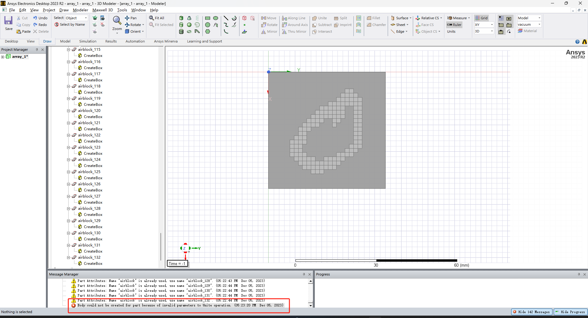

      On ANSYS EM 2023R2 maxwell3D, I want to convert the mnist pic into a 3D object. The pixel value equal the depth of the groove on the upper surface. So i create more than 100 vacuum cube that needed unite.  It works well on Ansys EM 2021R2. But recently I update to the Ansys EM 2023.2, it's always returen error like "Body could not be created for part because of invalid parameters to Unite operation". I tried to unite less than 50 object, it works well. But as i unite more entire 132 object, the error shows again. So how can I get the correct unite operation?

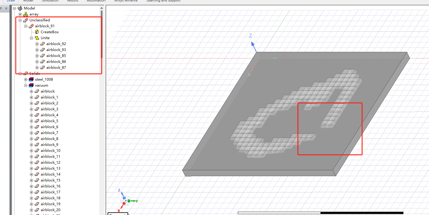

        Thank you! I really appreciate your advice, but i still get the error massage. Here's my detail:
        Step 1: I choose 40 objects to assign unite operation. It success.
        Step 2: I go to Modeler>>purge, all history are purged successfully.
        Step3: I choose another 40 objects to assign unite operation. The error shows.
        Error 1: There's an unclassified branch showed in project trees.
        Error 2: The error massage still shows "Body could not be created for part because of invalid parameters to Unite operation".
        error shows in the pic. Thank you very much for helping me continue to solve this problem.

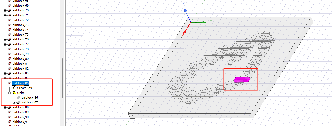

        1. I choose airblock_85, airblock_86, airblock_87 to unite, as show in Fig. 1. It success.

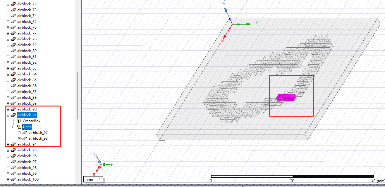

        2. I choose airblock_91, airblock_92, airblock_93 to unite, as show in Fig. 2. It  also success.
        3. I choose all airblock in step 1 and step 2 to unite, the error occurs, as show in Fig.3.
        The length and width of all airblock are all 1mm, the depth of airblock are randomly from 0.5mm to 1 mm. There are no gaps between adjacent airblocks. Please help me how can I get the correct operation?
