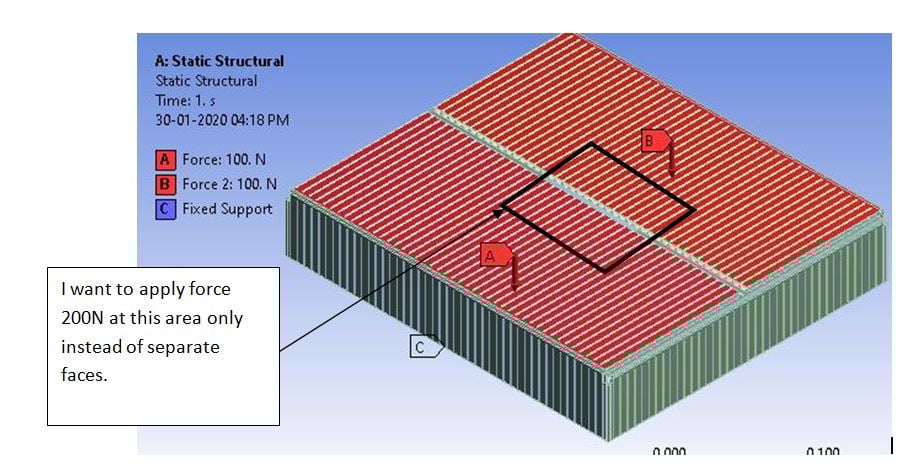

SubscriberOpen the Geometry in whatever CAD system created it, or in SpaceClaim and using a sketch, imprint that rectangle onto the face of the solid or surface body. That will break up each face into two faces.
