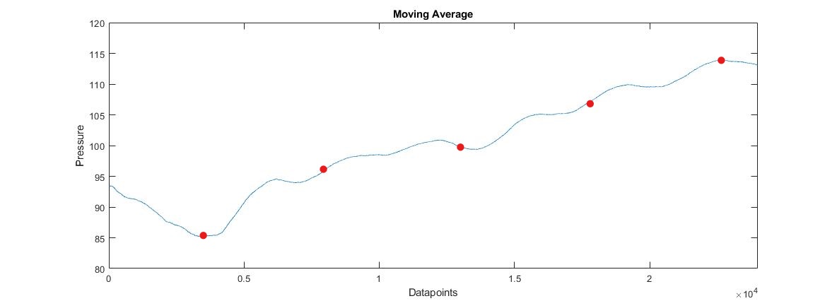

I have a transient data Signal, which is too large to map it on my blade that i want to examine. So i decided to
1) ramp the Mean value of the Data over stream lines to the blades in 5 time steps
2) apply the fluctuations (20.000 points) as point pressure in the most damage expecting regions
3) Do a lifetime Analysis of both added up in one model
I can do step 1 but i do not know how to combine it with step 2, in the same Model.
How to do that in Transient Structural?
Thanks for help!! -

May 3, 2019 at 12:19 pm
Gaddsch
SubscriberSure thing. In the image below you can see the plot of the mean pressure with 5 red dots. I wrote a script to interpolate the pressure value, measured at this specific time step, to the 200 points of the stream line, mapped on the blade that you can see in image 2. This creates a Table, (1) with (xyz)and Pressure.
No i want to ramp from step 1 to step 2 to step 3 etc. Im taking the tabular Data via external data and apply it to the blade.
The fluctuations are the Meassured Pressure-Mean Pressure, measured at the 24.000 points with a sampling rate of currently 2083Hz. I want to apply these points as a transient Data at a specific location on the blade and combine it with the ramped mean pressure.
Last image as explanation of the 7. I got 7 different streamlines starting from topto bottom of the blade.
Hope this makes it more clear. Thank you
