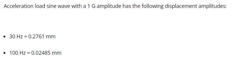

I want to apply a base excitation displacement that represents the engine vibration in a machinery room. The engine power is 3070 HP at 1050 rpm, and the analysis will be done in this range of frecuencies: 14 - 34 Hz.
I saw this reply, do you have any source that establishes what is the amplitude of base displacement adequate for a frecuency?
/forum/forums/reply/109903/
December 5, 2022 at 10:39 pm
peteroznewman
SubscriberHello Geovanna,
This website has a good explanation of the equations for simple harmonic motion.
If you start with a specification on the acceleration amplitude of 1G = 9810 mm/s^2, use the third set of equations that has the constant C for the amplitude.
In the example above, f = 30 Hz so w = 2*Pi*30 = 188.5 radians/sec.
The displacement amplitude is C/w^2 = 9810/188^2 = 0.276 mm.
In the description of your project, you mention the HP of the engine, and the RPM, but that doesn't help to define either an acceleration or a displacement base vibration amplitude that engine creates. The best way to know the base vibration amplitude that engine creates is to fasten an accelerometer to the base and record the vibration using a data acquisition system. I have experience with that instrumentation if you would like to discuss it further.
