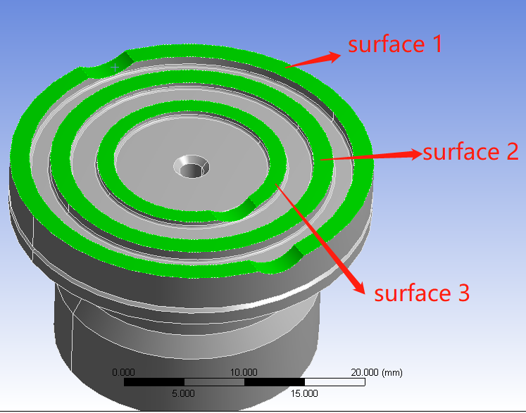

Hi, everyone, I am conducting a FEA simulation on the slipper of piston pump, the bottom surface of this component consists of three annuli, shown in Figure 1, surface 2 is the surface that I want to apply a pressure type load which conforms function p=ln(r2/r) just like what is shown in Figure 3.

(1) How to realize this load variation on surface 2, I heard that it can be realized by APDL, but this is relatively complicated, so, is there any other simple way to realize this, or the only way to reach the goal is whereby APDL?

SubscriberThank you for a completely described question! You can get what you want without resorting to APDL.n#1. Make a Cylindrical Coordinate Systemn
#2. Use Excel to make a table of Pressure vs Radius. In the example below, I put a P in front of your equation.n
#3. Create a Pressure load using Tabular Data. Set the Independent Variable to X instead of Time. Use the Cylindrical Coordinate System and copy/paste the Excel cells into the Tabular Data field. Just pick the first cell and Paste.n
Static Structural is the right place to build this model. Transient Structural is useful if accelerations are high enough to generate significant inertia forces.n
